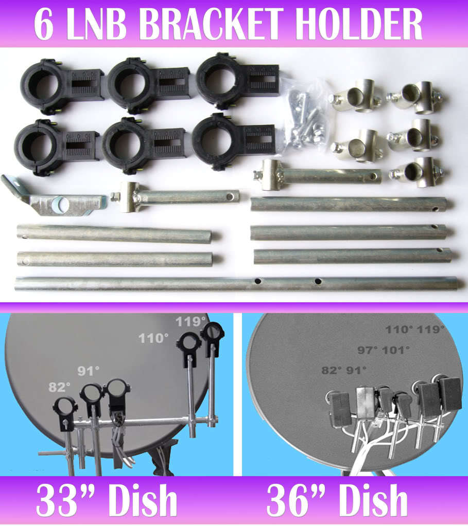

This might help .. I've always been tempted to use one of those adjustable LNB brackets..
I'm using one of those on a 30" dish for 91-97-103, but I wonder if non-DBS satellites are really do-able any wider than that. For some reason all the pictures always show 82-91-110-119 :rolleyes:
I would definitely point at 116.8w and with a bracket try to pull 93w which like Iceberg said, its the stronger bird.
Uh huh...
The DBS satellites are much higher power, so they can get away with doing 82-119 easier.
