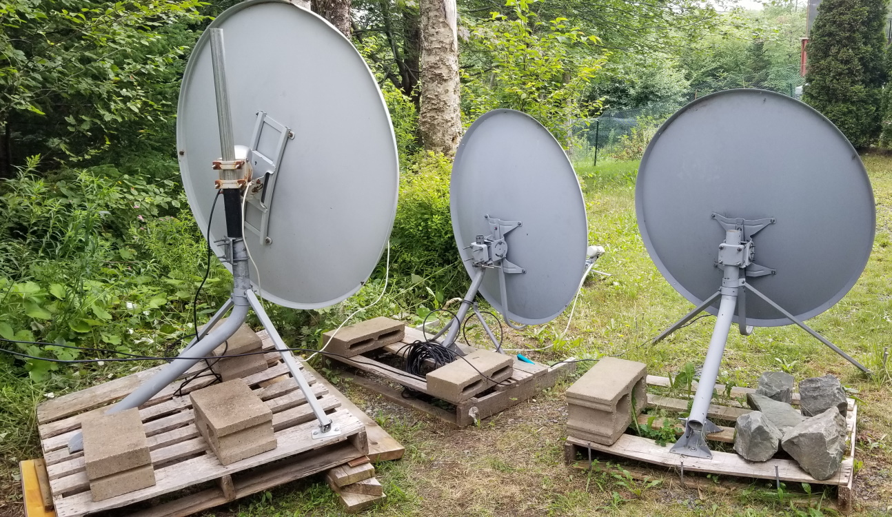

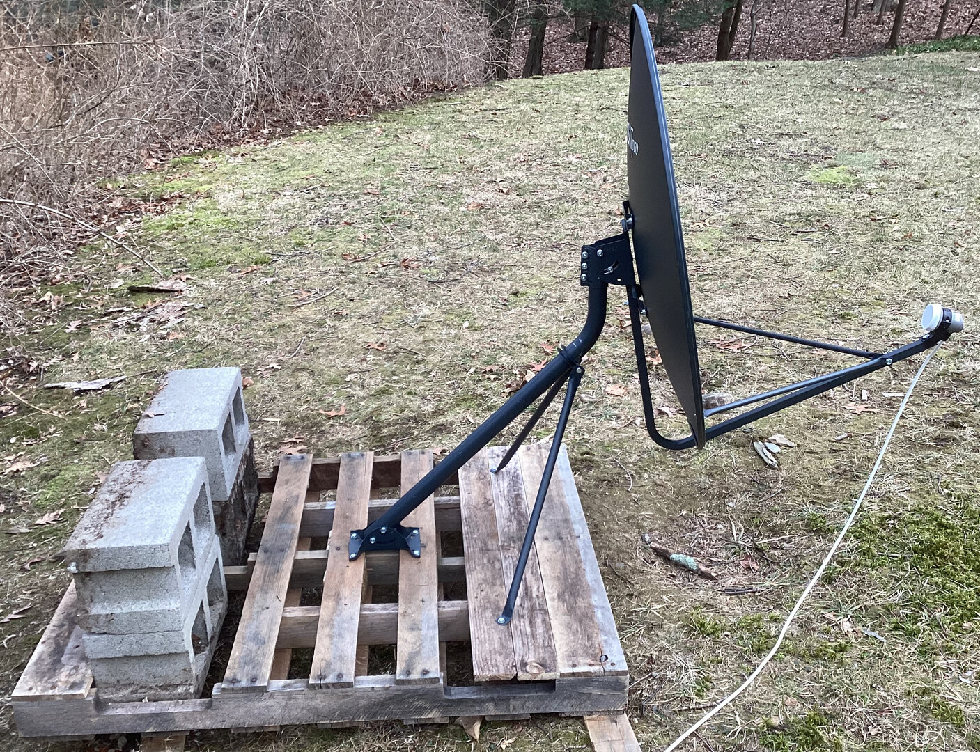

Yesterday, I got 3 new pallets. One Pallet was intended to mount the Dish on and the other two were dismantled completely for parts. The cross beams from one pallet fit perfectly into the new one. I only needed to hammer them in place with a rubber mallet and I was good to go. They were secured in place with nails. (See pic #2). This improved the strength of the pallet as the planks did not stress under pressure any longer. As you can see toward the rear of the pallet there is an area of the pallet allowing a fork operator to lift the pallet. I took advantage of this area by placing cinder blocks into it so that this would weight the pallet down. 1 block weights about 13 kilos.

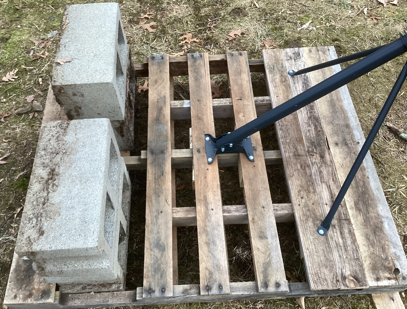

In image #3, I salvaged some blocks from another pallet and strategically placed them inside the pallet so that when I fastened everything down there would be more meat for the screws to dig into.
Picture #1 shows the finished setup. The satellite dish is strongly fastened down onto the pallet and the added weight ensures it stays fixed in place.
I spent a few hours searching for Galaxy 19 to no avail. Then I decided to Change the skew in the opposite direction and BINGO! Dish pointer needs to use clear language for this setting as their illustrations tell otherwise. Not good for an app you pay for!
The Setup I have is only temporary. The first thing I wanted to learn was whether or not it was possible to get FTA from my location and now I know 100% it is. I also need to determine the best place for a permanent install as I would like to pan for other Satellites as well.

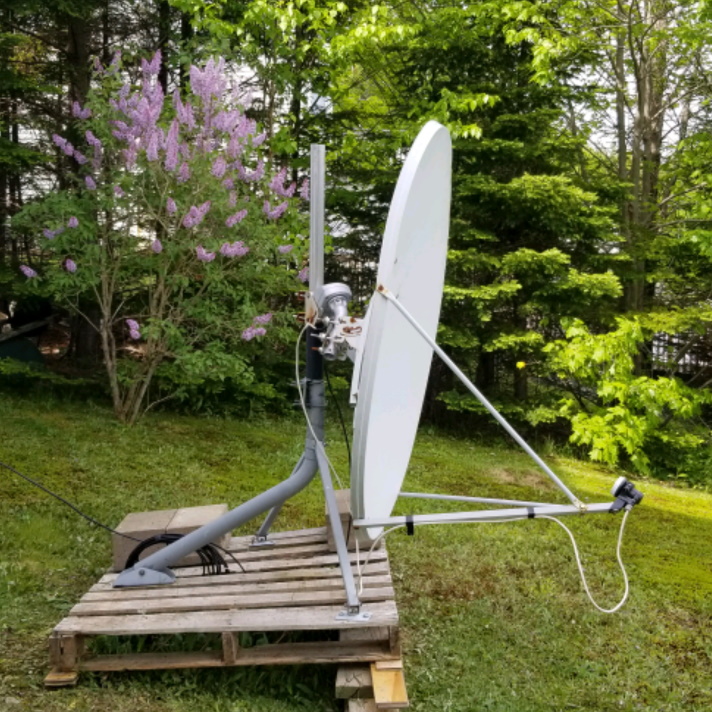

Great minds think alike. I enjoy pallets so much I couldn't give them up. Note my fine tuning system of shims under the pallet.
ADDED: I used a spade to lift an edge of the pallet to insert the fine tuning slats of wood. It was elegant. All were mounted in the middle of my driveway. I dismantled all in a few hours when I sold my place.

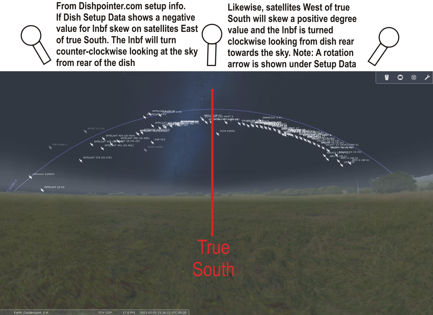

Why on earth did you do that? :shh;):shh
There are also satellite aiming apps free of cost, I believe. So that you would have some money left to donate to satelliteguys! :)
I've never used such apps, however. Satellite beeper and inclinometer (app), that is what I use.
And of course, www.dishpointer.com, for the aiming map, and the calculations.
(Though for the calculations I also have my own spreadsheet calculator.)

I like that image. Where did you find it and how can I get one that shows only the satellites?
It's an astronomy program I use called Stellarium. It took a bit of configuring to show the Clarke Belt sats and the arc they are in. Haha, I wasn't even sure I could do it. Then dropped the screen shot into Corel for the rest of the crap. That was the easy part!
