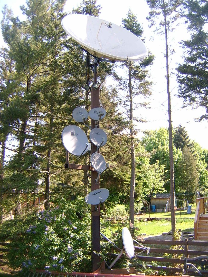

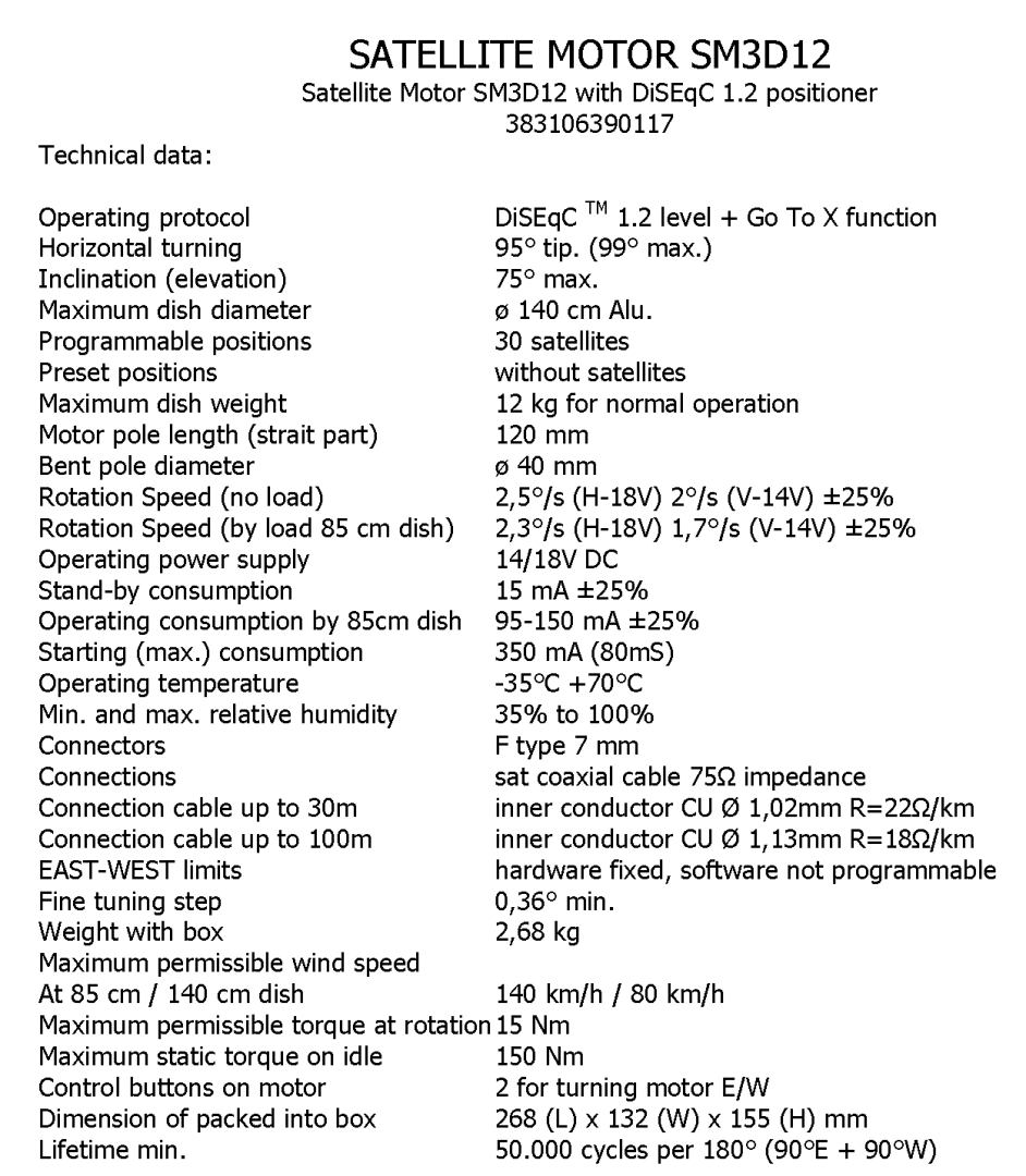

It is actually a SM3D12 by Multistar that is a clone of the Stab. I swapped cable (new one I ran just to test). I can move the dish with the east/west keys on teh rec. disec2 screen, but Goto X has no result. Same with changeing sats. So no problem from rec. to dish. Problem is in receiver. I will swap with another receiver to test, but I already have a new receiver coming from Amazon. Should be here next Friday. It worked last week with another receiver that I moved to another dish. Logically, it HAS to be an issue in the receiver.

Not exactly a Stab clone because apparently it's only diseqc 1.2.
Which means you'll have to search for sats and store them to a position like big dishes.
How? Yeah.
Limited arc travel might mean it's time to swap for an SG2100. Then you'll get your usals.
