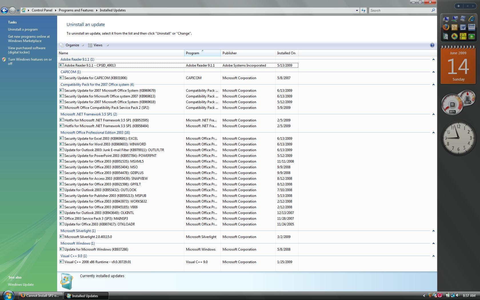

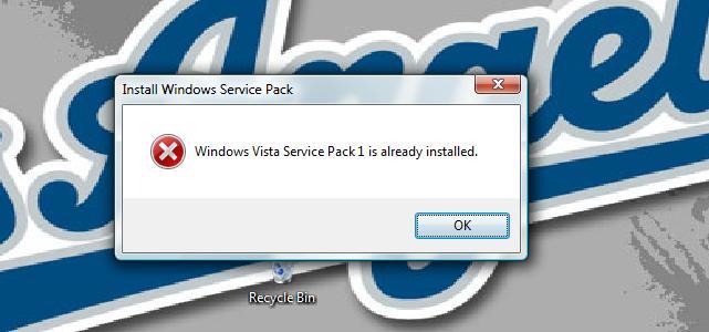

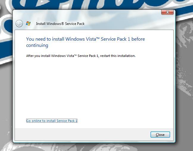

Vista will not let me install SP2. It says I must install SP1 first. SP1 is already installed. When I go to install SP1 it states it is already installed and won't let me install it. I tried to remove SP1 before I install SP2, but it is nowhere to be found in the view installed updates.
Catch22: Cannot install something until I install something else that is already there but cannot be found. :rant:
This again, is an issue with the same piece of junk laptop I have. My wife's laptops and all three of my desk tops have yet to have any issues with Vista. This laptop I am currently typing on has one problem after another. (I even fixed hard drive errors and corruptions yesterday)
Any other suggestions? I have been trying to fix this issue all day yesterday. I cannot do any other updates until I do my SP2 update first.
