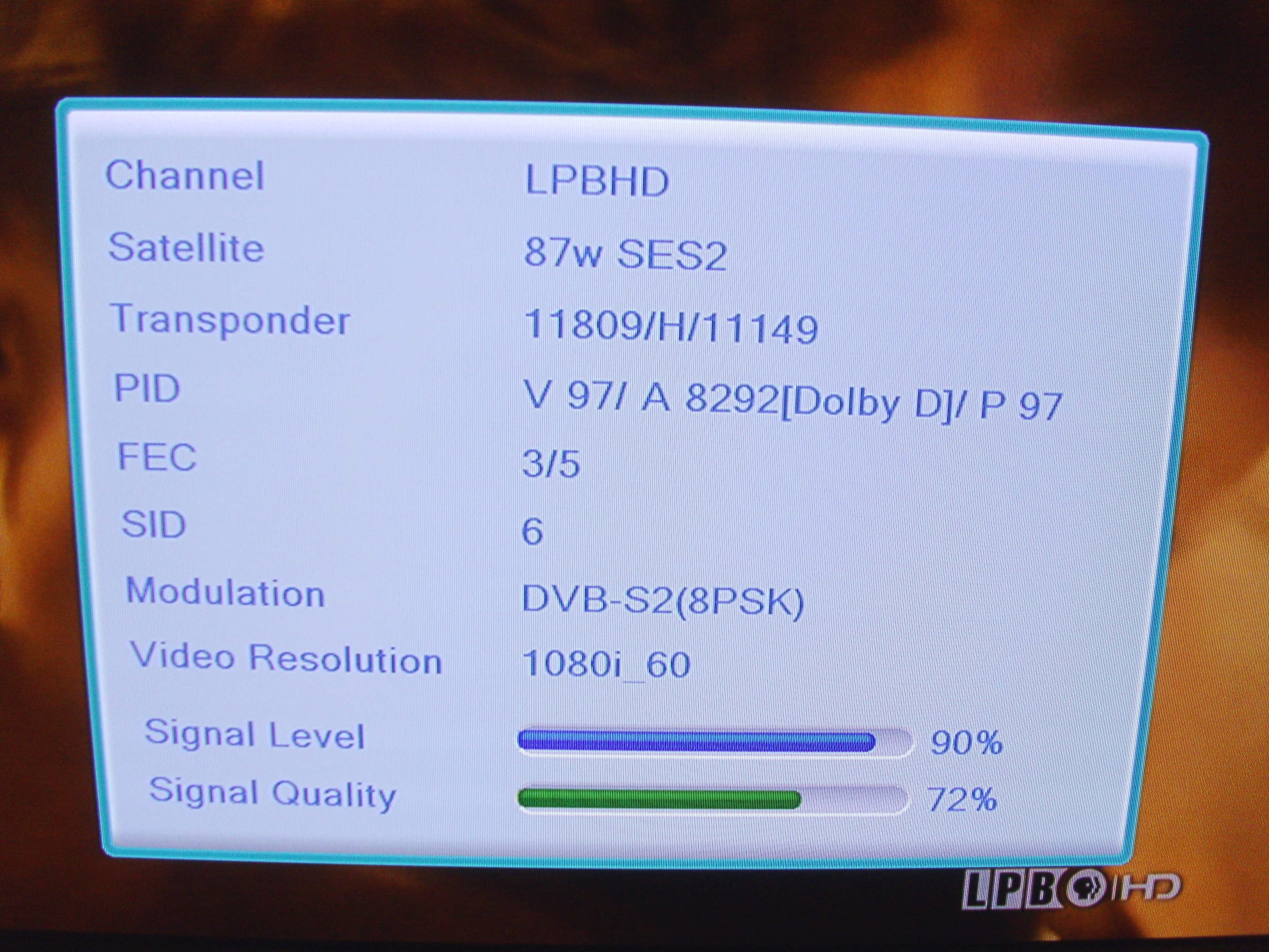

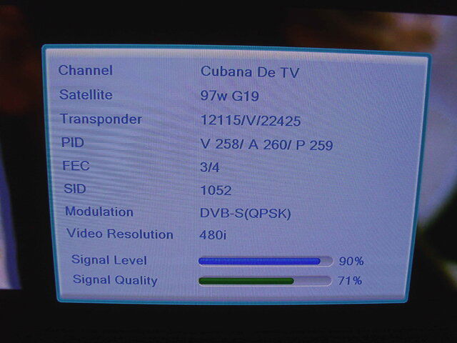

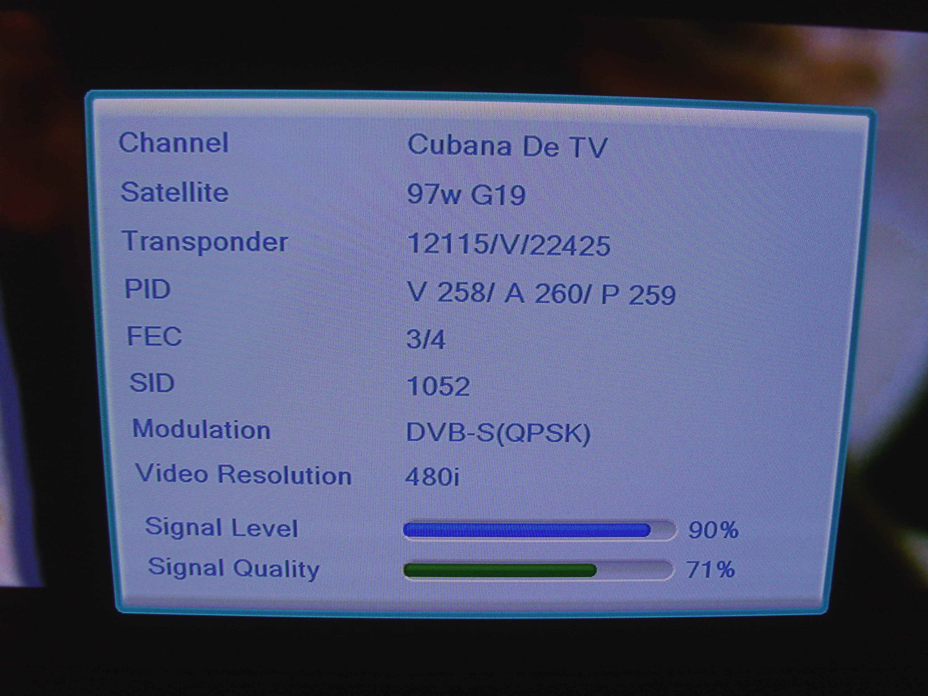

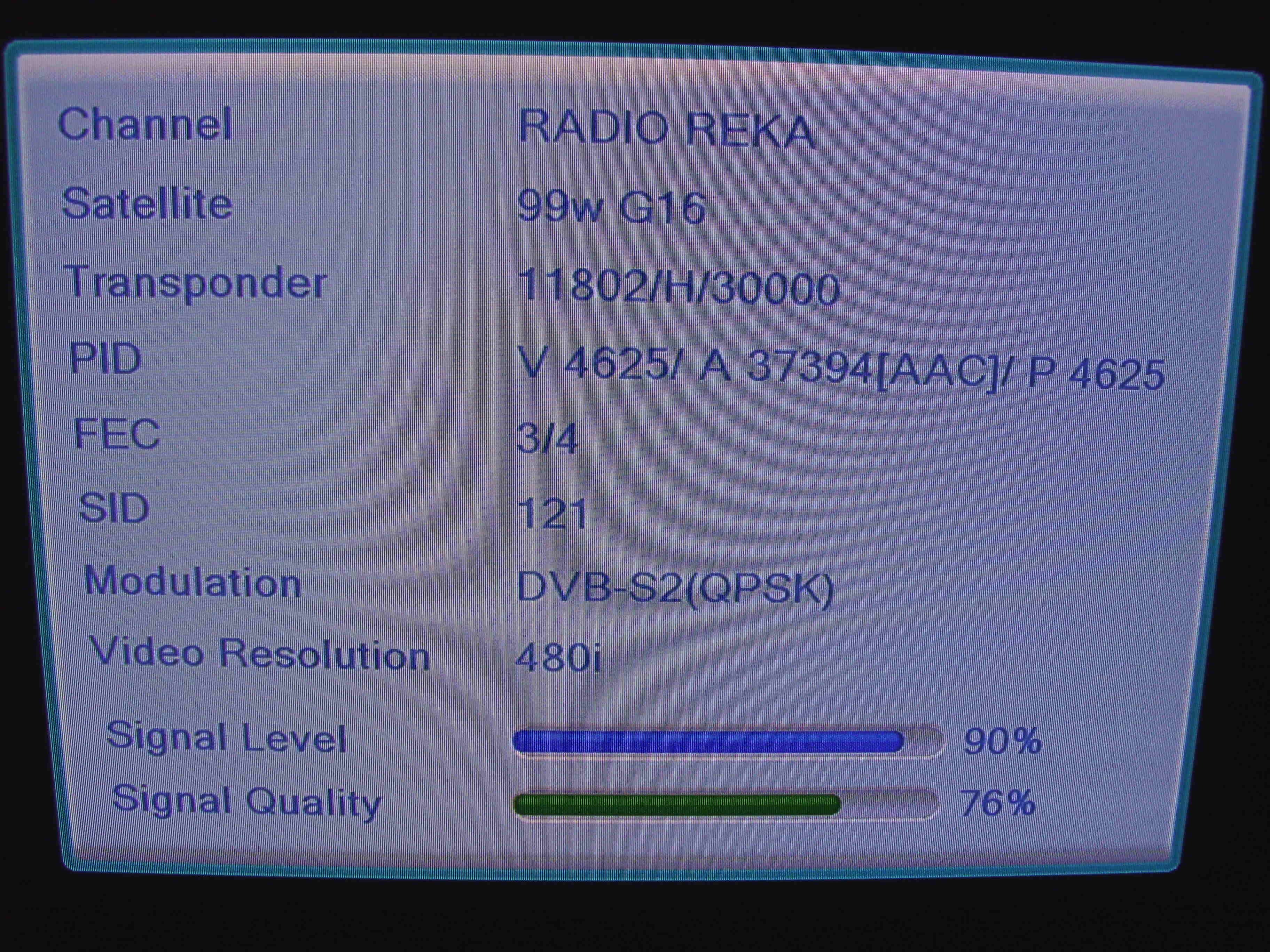

see attached pics
1st pic is DVB-S QPSK (test card on 91W KU) MPEG2
2nd pic is DVB-S2 8PSK (LPB HD)
3rd pic is DVB-S QPSK (Cubana DeTV) but MPEG4...it doesnt say that but on my Coolsat 5000 it shows up under radio
4th pic is DVB-S2 QPSK
