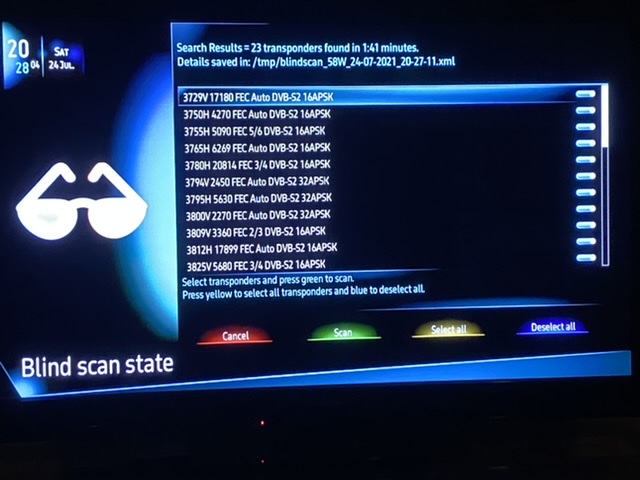

Hi all,
In my continuing quest to find 55w and 58w, I found these 16 and 32 aspk transponders in the general vicinity of these two satellites last night. Does anyone know what satellite I was on ? Even though my stb found them, it wouldn't " load" them.
I'm attaching a photo of last night's find.
Just ignore the 58w heading in the photo.
Thanks in advance.
John
cyberham,
I scrolled through the entire list last night and didn't see anything that would tell me what satellite I was on.
BTW...why doesn't my stb save these transponders ?
Thanks.
John
They don't get saved because the receiver doesn't actually "scan them in" like a regular tp. But I use Menu item 5 to "add service to a bouquet" with bouquet name of the satellite once you know which satellite they are from.
The fact you found 23 tps across a broad frequency range and none are from a recognizable source is a clue itself. Somebody with a big C dish will chime in soon. Brct203?
Sent from my SM-G950W using Tapatalk
Reactions: JFOK

I checked on Lyngsat and didn't see anything that matches those on 55W/58W or the sats near them. :(
When you press the green button to scan do you get any channels saved?
Reactions: JFOK
cyberham and FTA4PA,
I also checked Lyngsat and tvrosat and couldn't match up any of these transponders.
When I press the green button to scan these in, nothing is saved
John.
John.
Have you tried bumping the dish east and/or west a click or two from it's current position and scanning again? I know in the past when I wasn't directly on a satellite I would sometimes get weird results for transponders and nothing would scan in.
Reactions: JFOK
There is a very strong CNN Brazil tp on 4095 L 40000 that you can receive for sure. You can program frequency and just motor using Positioner Setup until the signal pops in. That would give a reference.
Reactions: JFOK and FTA4PA
