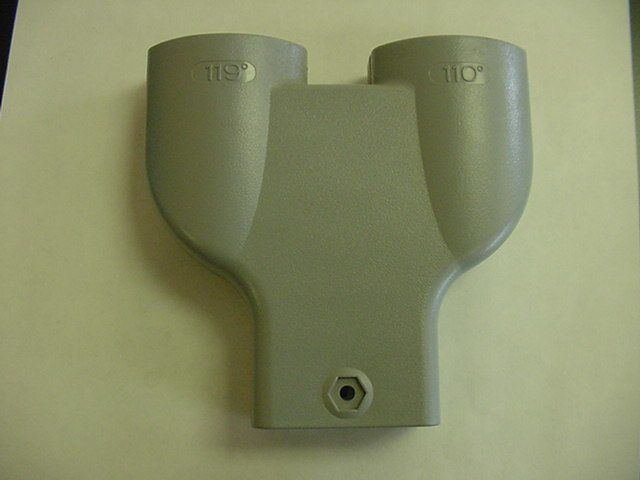

Looking from the back of the dish, cover the right eye of the Twin Lnb (110) with aluminun foil (it's also labeled on the Y bracket). Find 119 and then remove the aluminun foil and run check switch. If you have the skew and elevation correctly then 110 will fall into place.
To find the azimuth, swing the dish slowly from left to right. When in the point dish screen on your TV, use 119 and TP 11.
This picture is from Dishstore.net (for ilustration purposes only):
