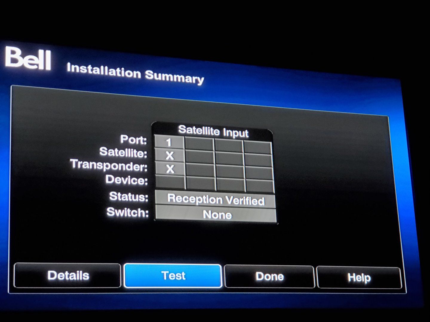

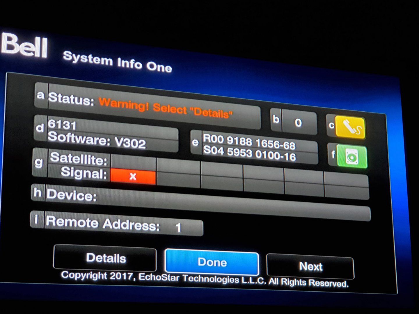

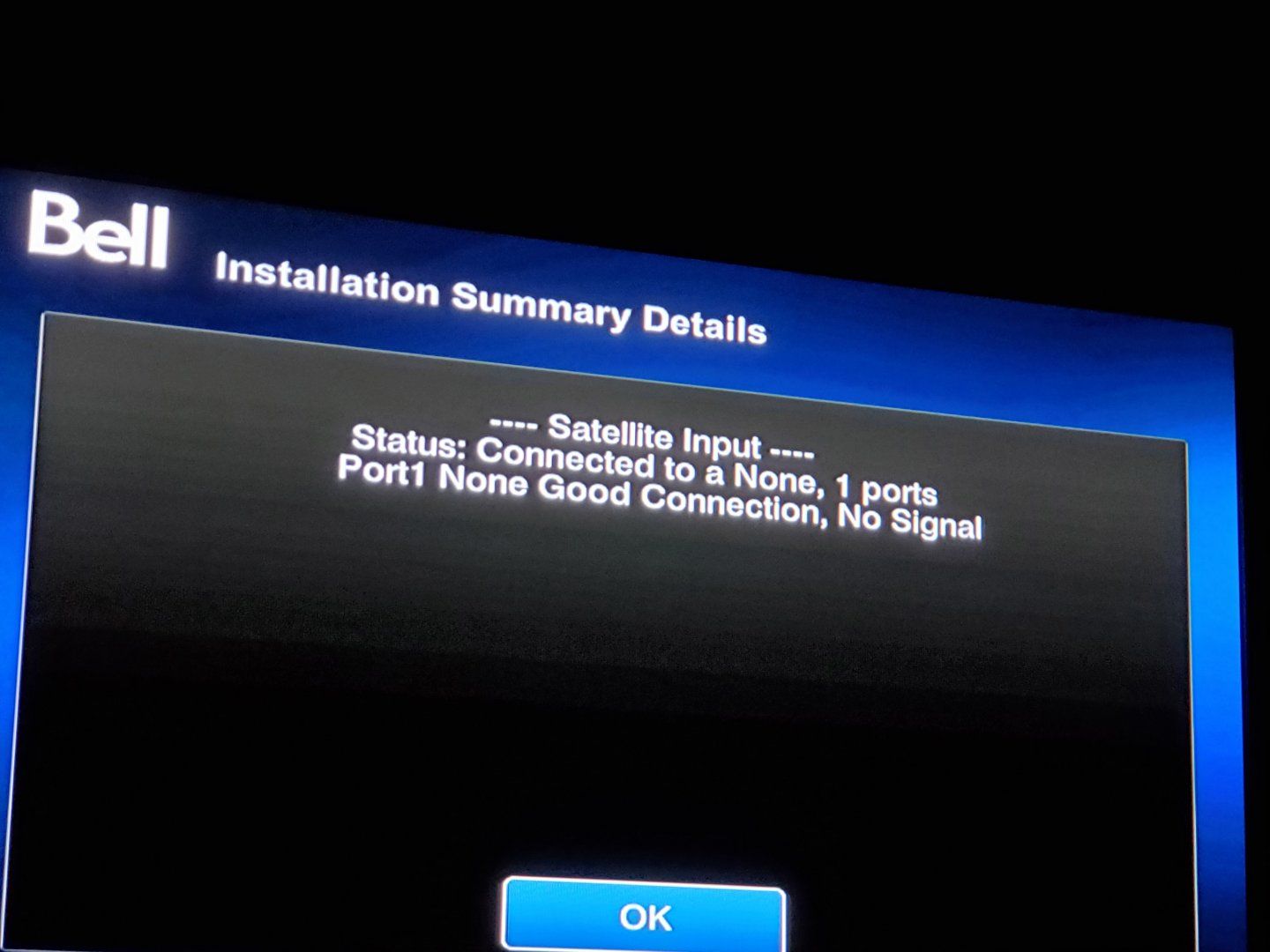

It does not appear to me that the receiver is recognizing the switch or LNBs. Here's the screens I'm looking at.
No it sure does not. :( OK; we've got 18V at the LNB end of your coax, so I am guessing it's not the coax and not the 6131. You told us above that you already tried replacing your LNBs and your SW21 with no change. I think you have multiple failures. Let's leave the switches out of the picture and direct-connect the 6131 to each of your (4?) LNBs in turn. I think you tried some of your LNBs directly, but did you try all 4?
