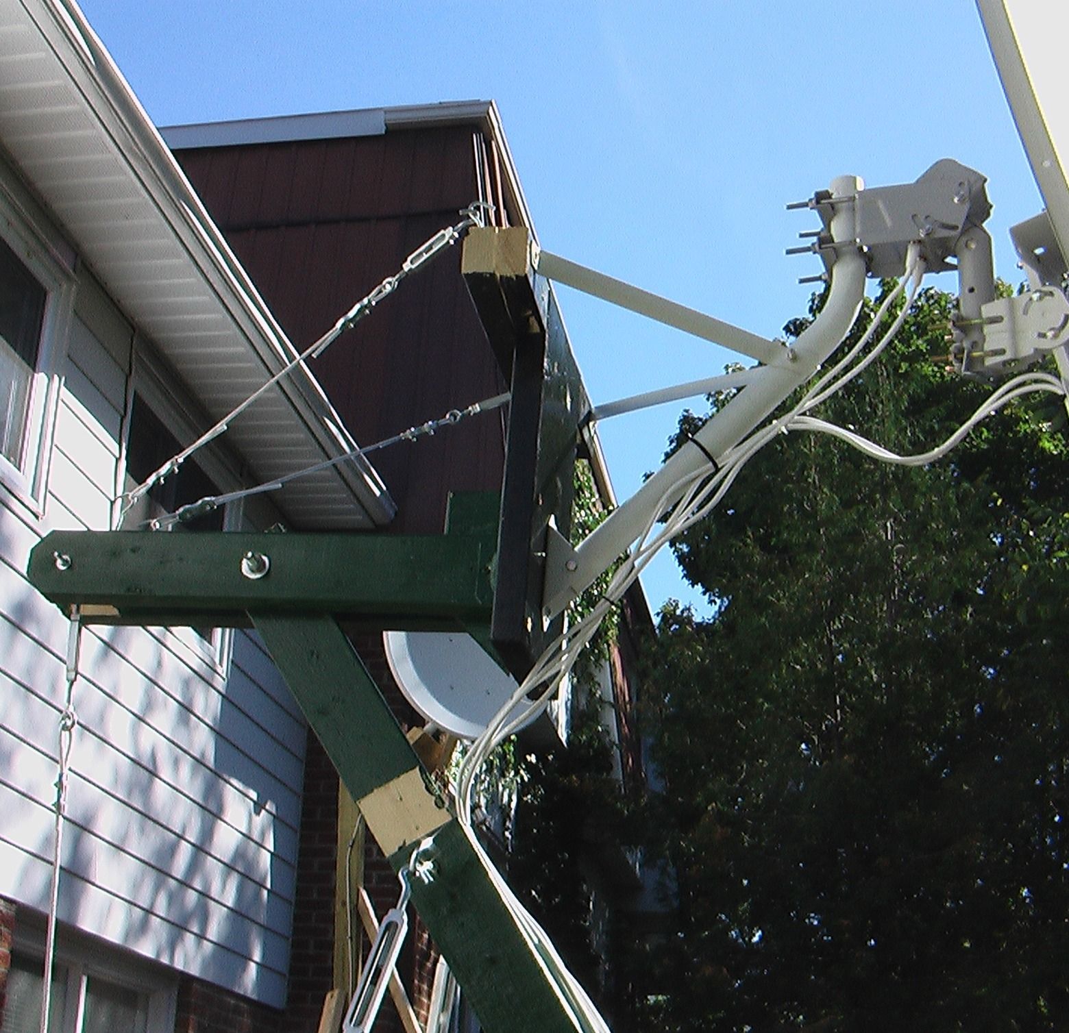

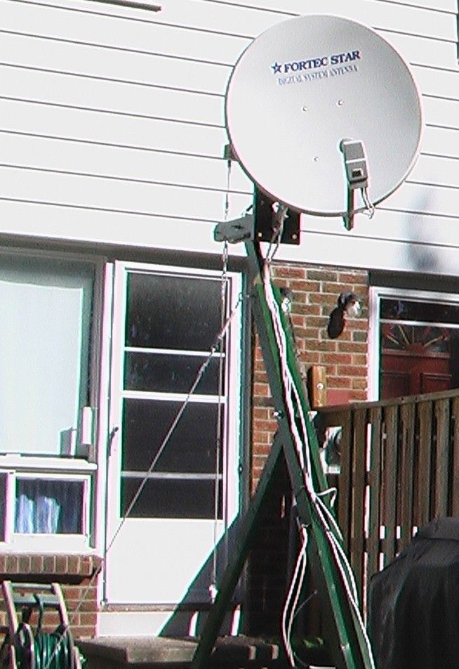

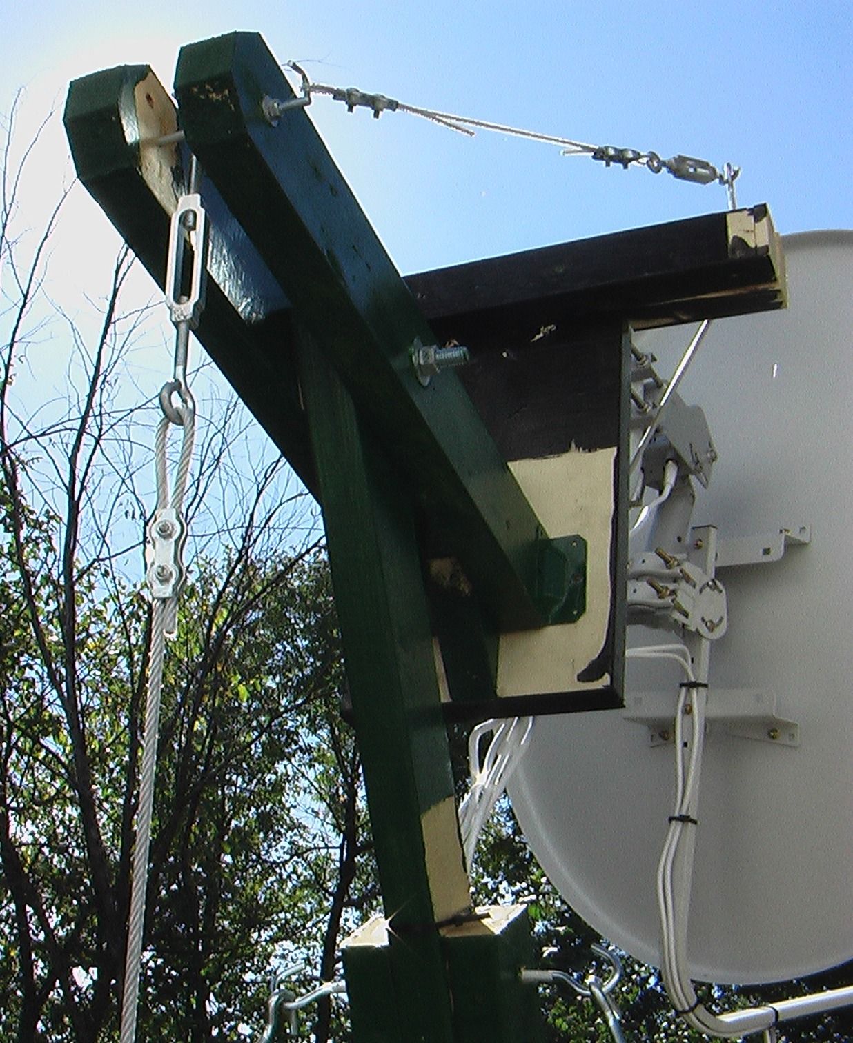

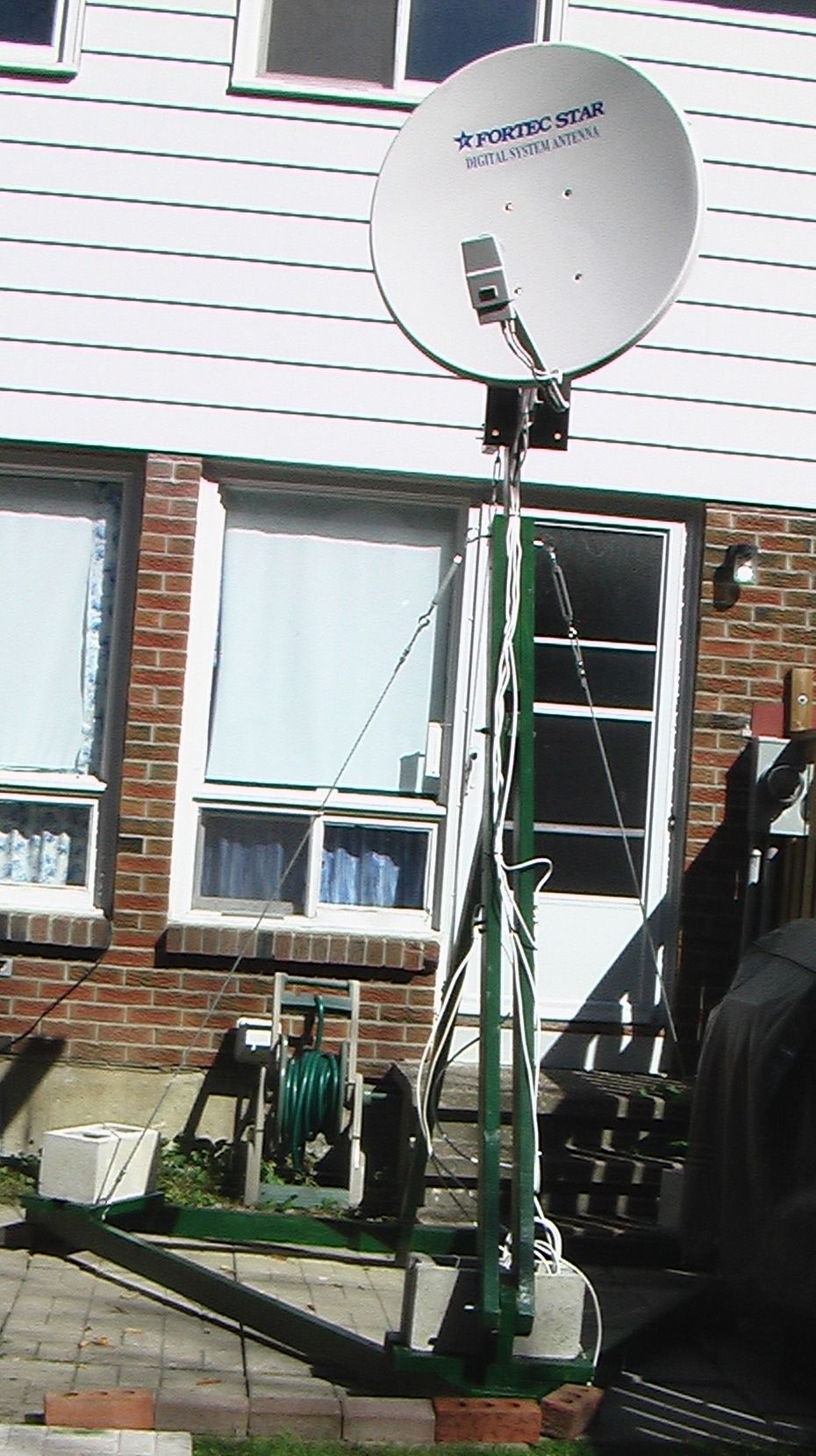

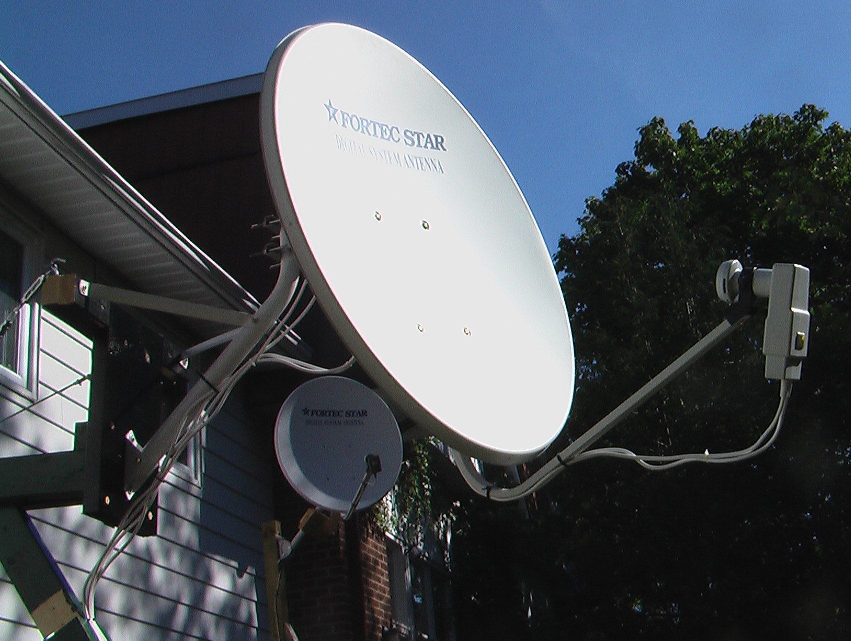

I'm enjoying my new setup otherwise. Here is the platform the dish is on. The other dish belongs to my neighbor. He's Chinese and doesn't speak English or French so I haven't discussed with him what he can see with the smaller dish.
Here are some photos of the platform. Normally I would have just put the dish on the roof but because it's an attached townhouse we're not allowed to do that. The parts that are unpainted are where I redesigned the faceplate and extension spar to make them shorter and lighter.
