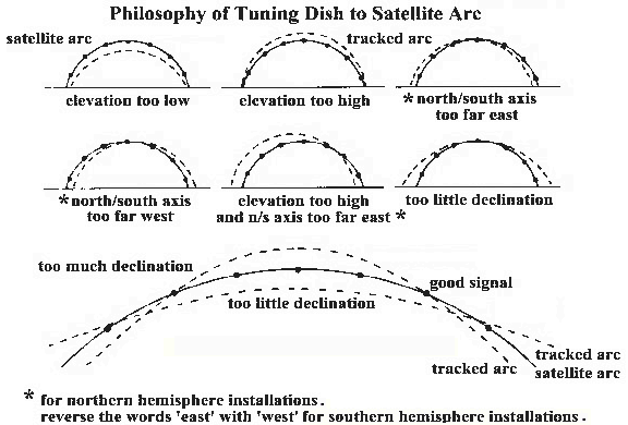

Here is a Pic that may help....
First thing is make sure your pole is still level and then remember that any adjustment that you make with with either the declination angle or elevation will have an effect on the other settings. It sort of a balancing act on adjusting the dish and always make small adjustments then recheck your satellites.

Lak7 from studying that page on the Geo-Orbit document the only thing I can make sense of is: The Dish has too little Elevation, and needs a slight N/S adjustment to the East??
