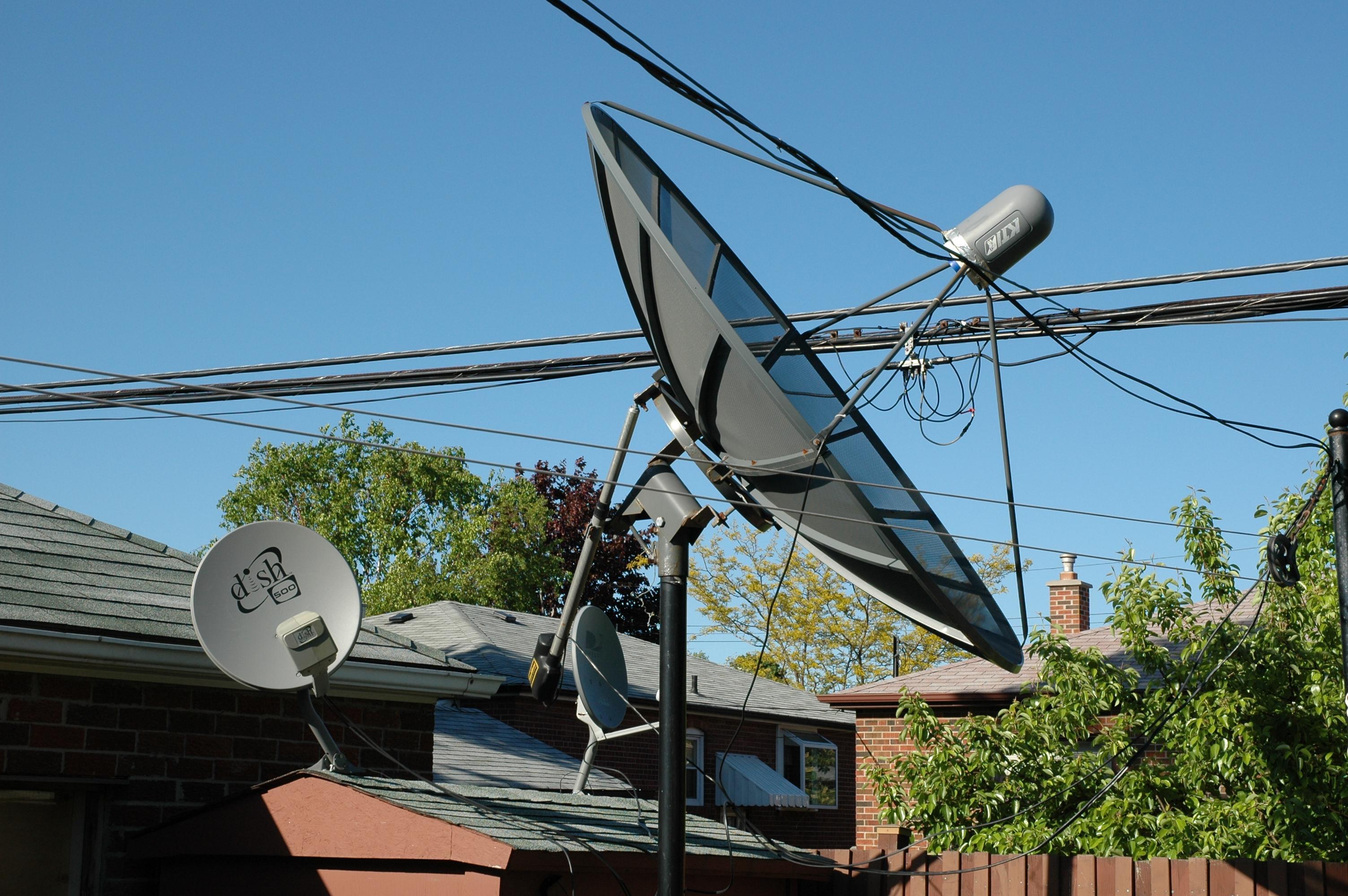

Can anyone tell me when setting up a big 8 foot dish ,,, how do i figure out the elevation? Because there are no elevation markings on my dish. I'm attaching a pic of how my dish looks like.
If you are moving the dish locally as long as you don't touch the mount the elevation should be already set for you.
Normally, though, you would use an inclinometer to set your angles.

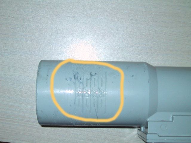

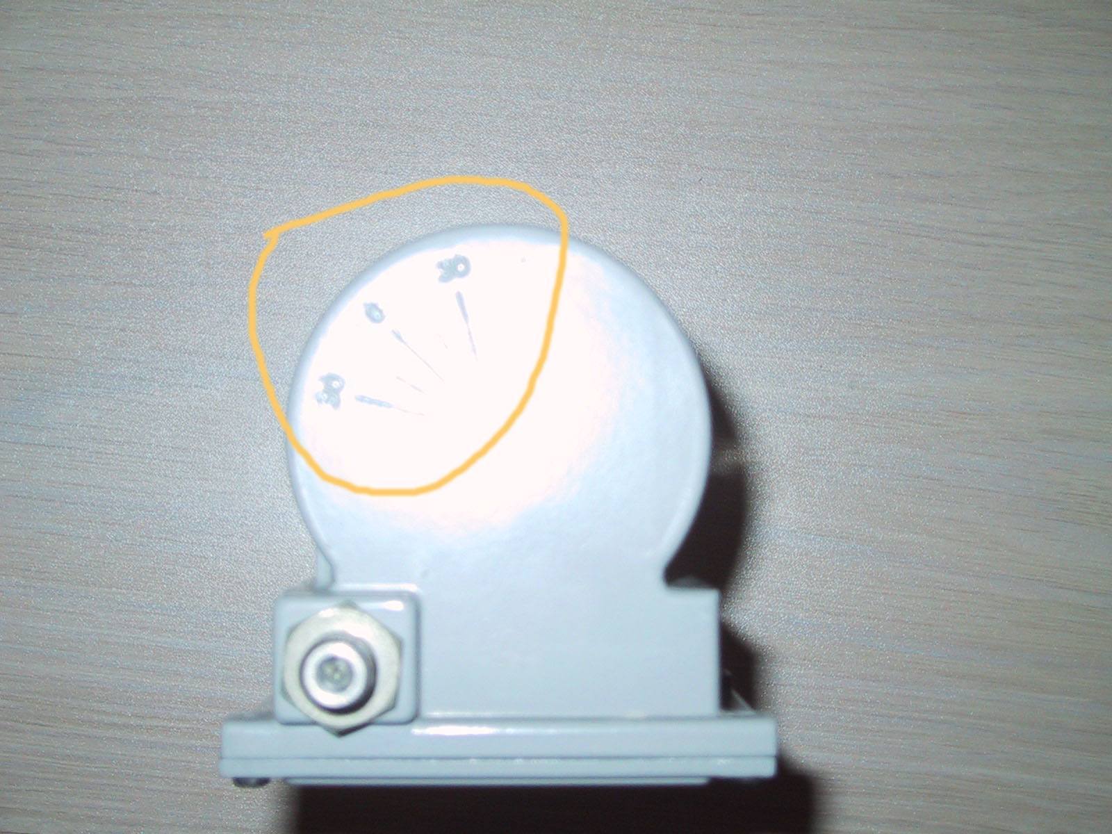

okay i think i've got the elevation good now. Used Sadoun calculator 34.6 was my elevation. But here's another question. On these LNBF how do i know what to set the skew too??. Because theres markings on the side and top and I have no clue on what it should be set at.

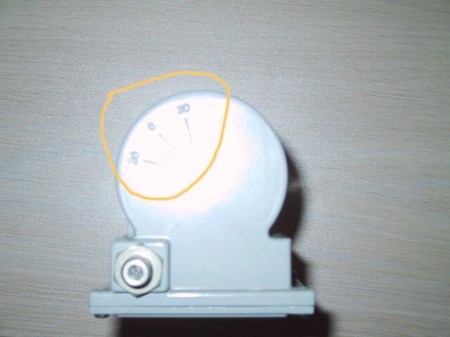

The picture on the left is your f/d ratio. One of the links above probably tell you how to calculate that. You sorta measure the width of your dish and your "depth" of the dish and do some simple division and get a number like ".42"... When you slide the feedhorn into the collar on the dish, you align the .42 (or whatever) with the edge of the collar.
The right picture, 0-90 ...I'm not sure. Anyone?

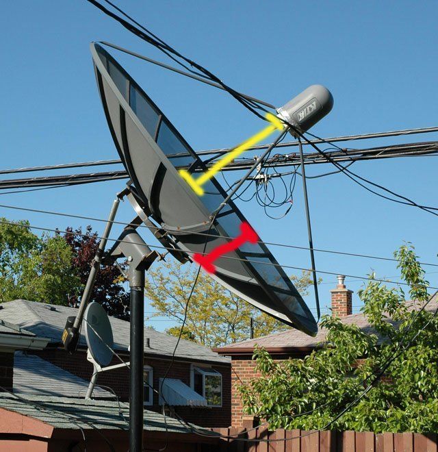

Depth
I was just looking up the formula to calc the f/d ratio.
Example
D x D = 120 x 120 = 14400
16 x d = 16 x 18 = 288
D x D/16 x d = 14400/288 = 50
focal distance f = 50 inches
seems simple enough, but i just want to find out where to measure the Depth.
I've attached a photo of my dish again with markings yellow and red. If someone can just let me know where to measure from (yellow or red).
Hope i made sense...
run a straight line (straight edge or piece of string) across the dish from edge to edge and measure the depth from the straight line to the center of the dish.
