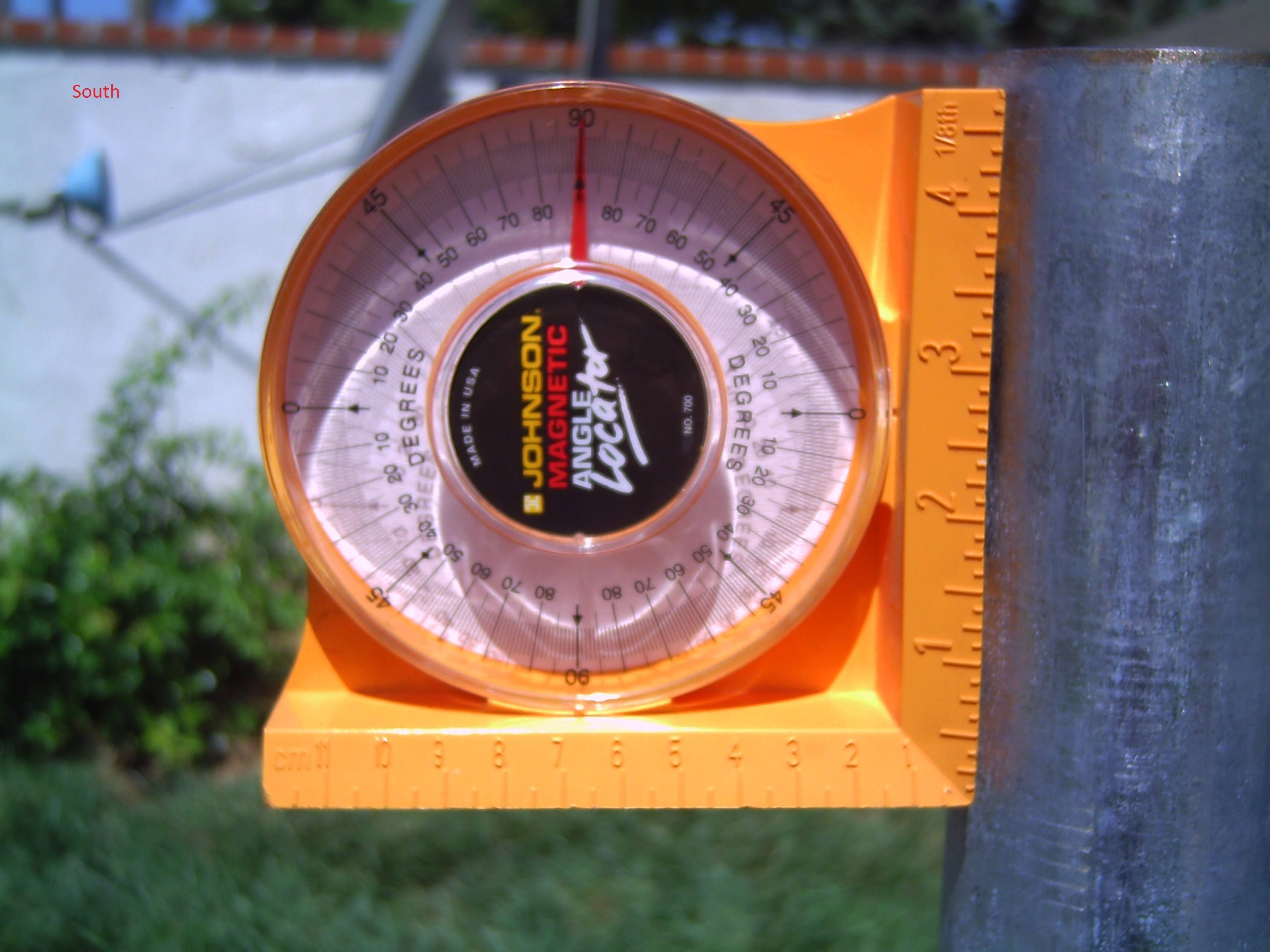

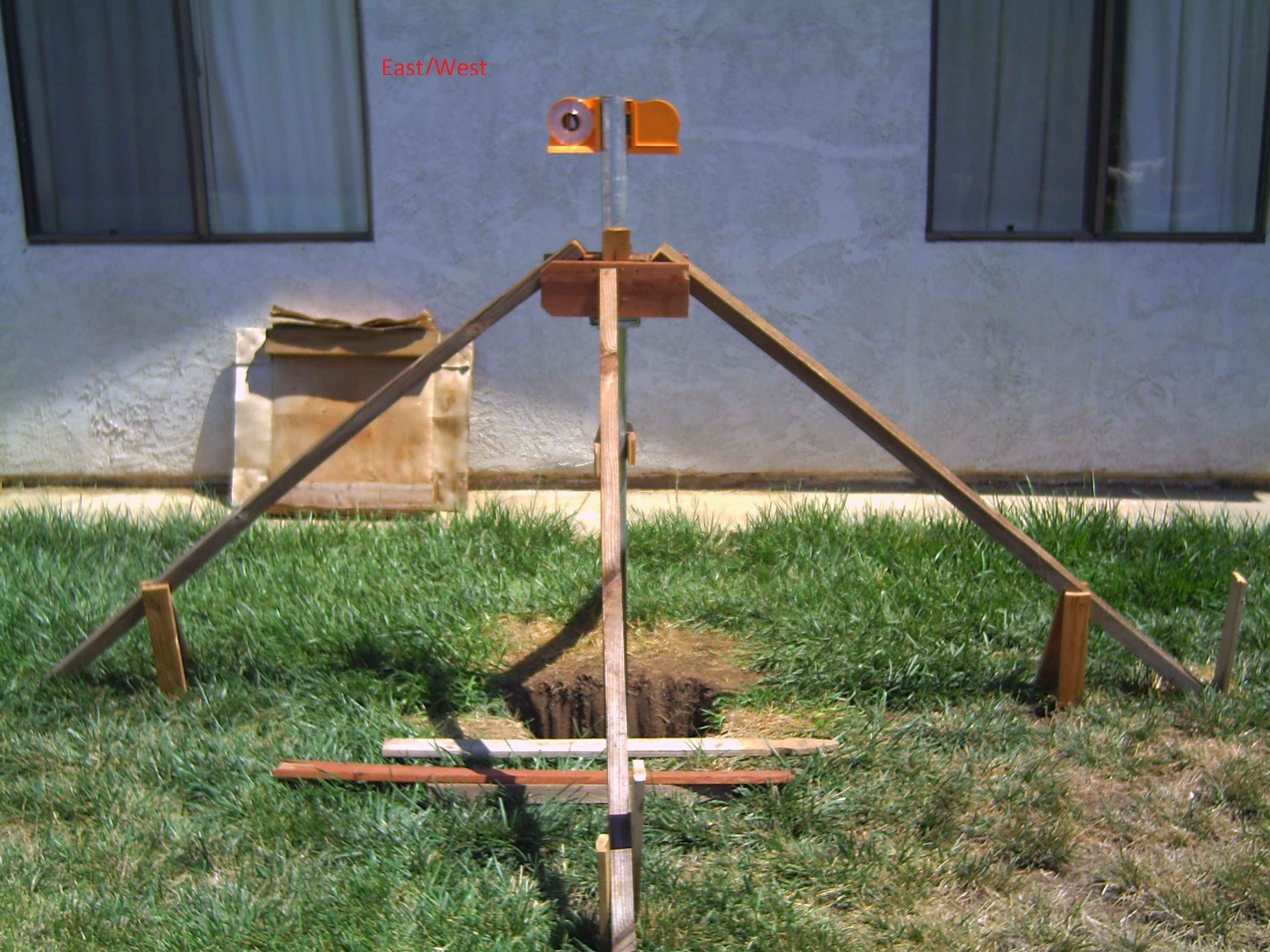

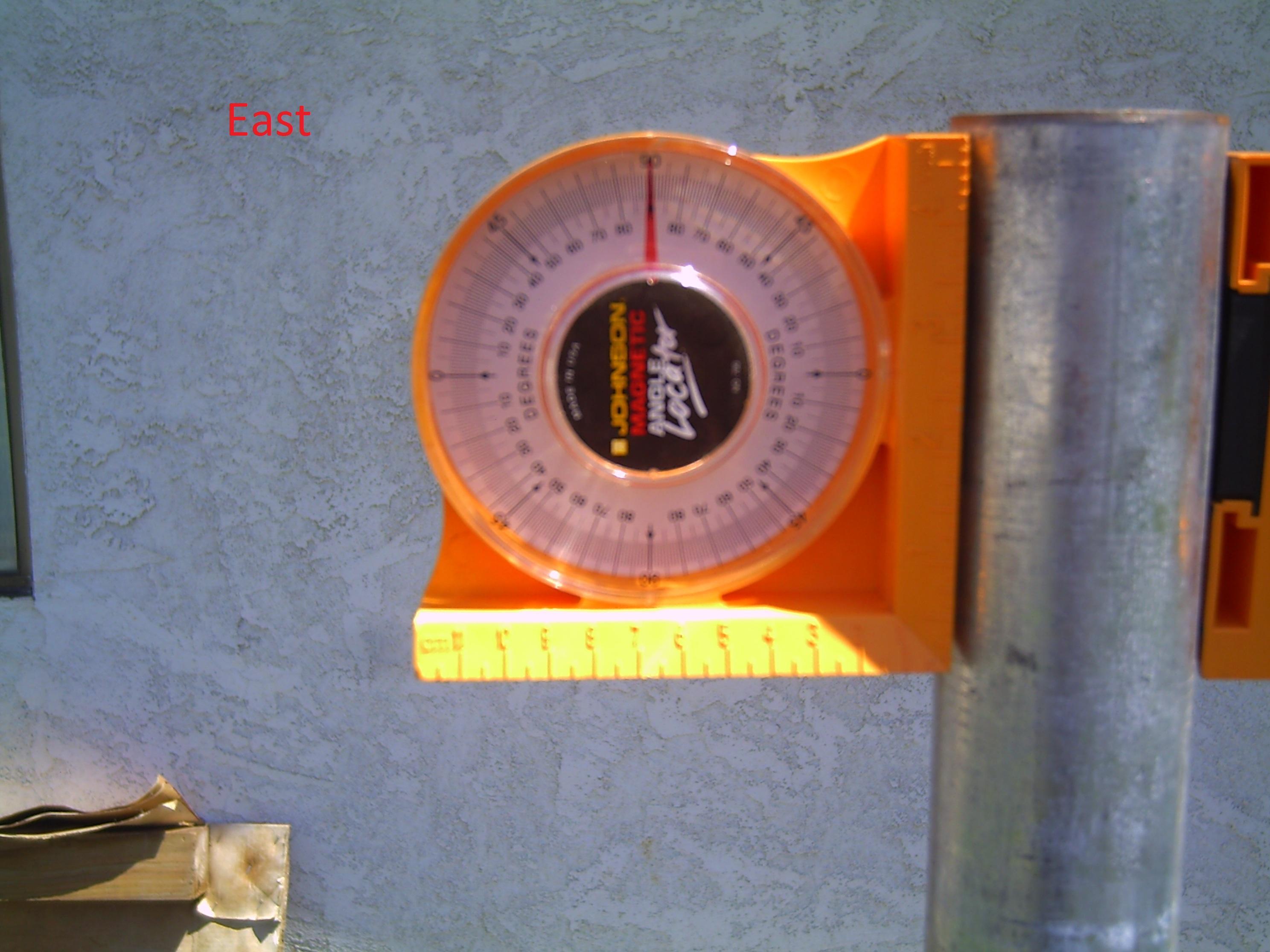

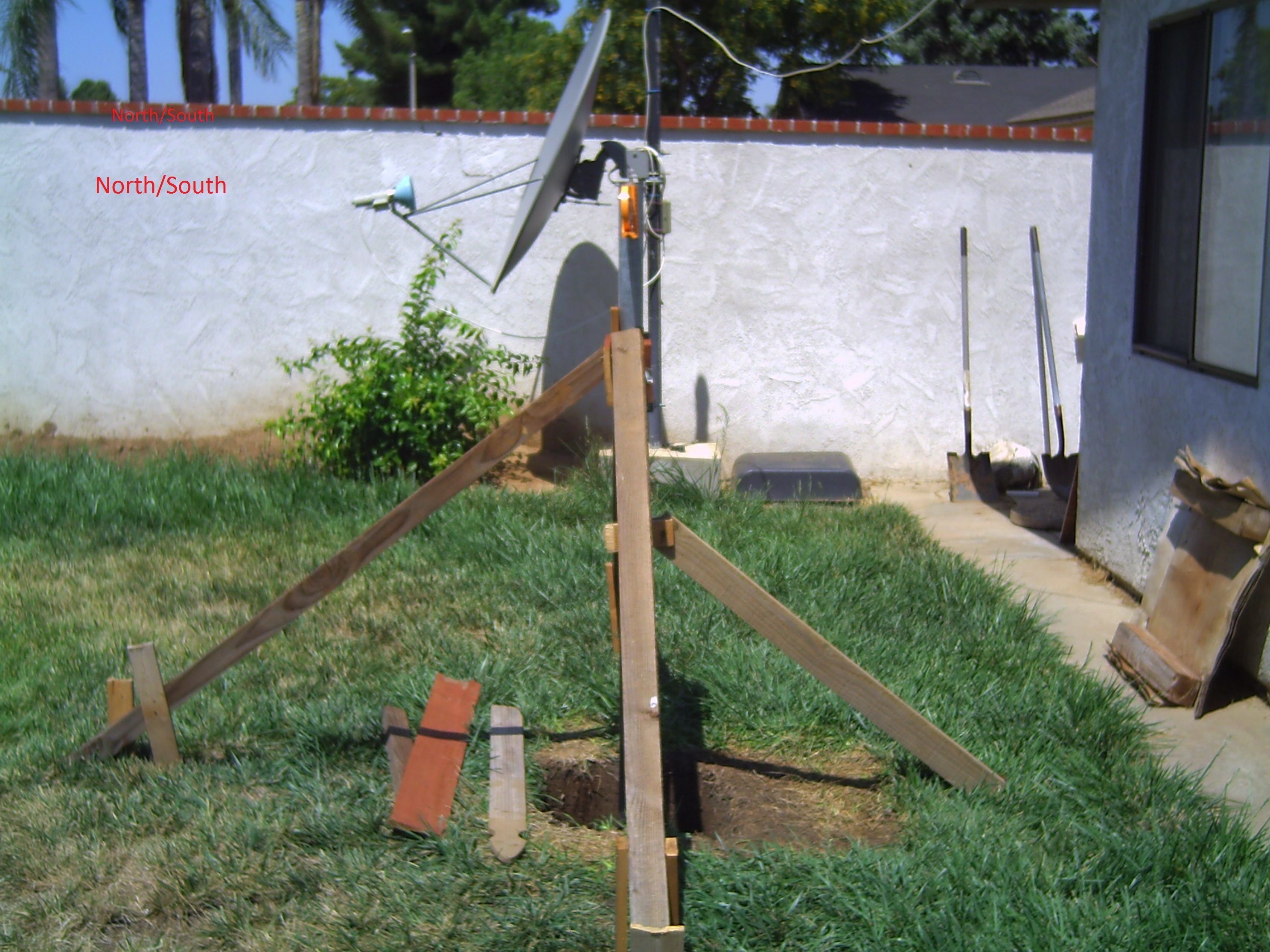

Hello Gents
Thanks for your input, the hole is 3.5 feet deep by 20 inch square, according to a Cement calculator It downloaded it should take about 14- 80 lbs bags, I read Dee-Ann Thread anfd ask her how many bags she used on the c foot dish setup, she claims she only used 9 to 10 bags and the hole is are 18 inch to 20 inch by 4 feet deep, so I am buying 13 bags just in case.
here are some pictures of my setup.
Regards
Chewie

One suggestion is to get a pole level that sticks to the pole. They are available at most Lowes and Home Depots and places in between. This type of level sure works great for me when setting poles and posts and it sure helps get that pole plumb!

Hello Gents
Well, I pour the cement today it took 10 bags of it, I got me some help, it took us about 2 hours, with my setup the pole did not move at all, right now the temp. is about 96 d out there, so I put a tarp over the wood to keep the sun of it until it cools off.
I will take it off during the night.
