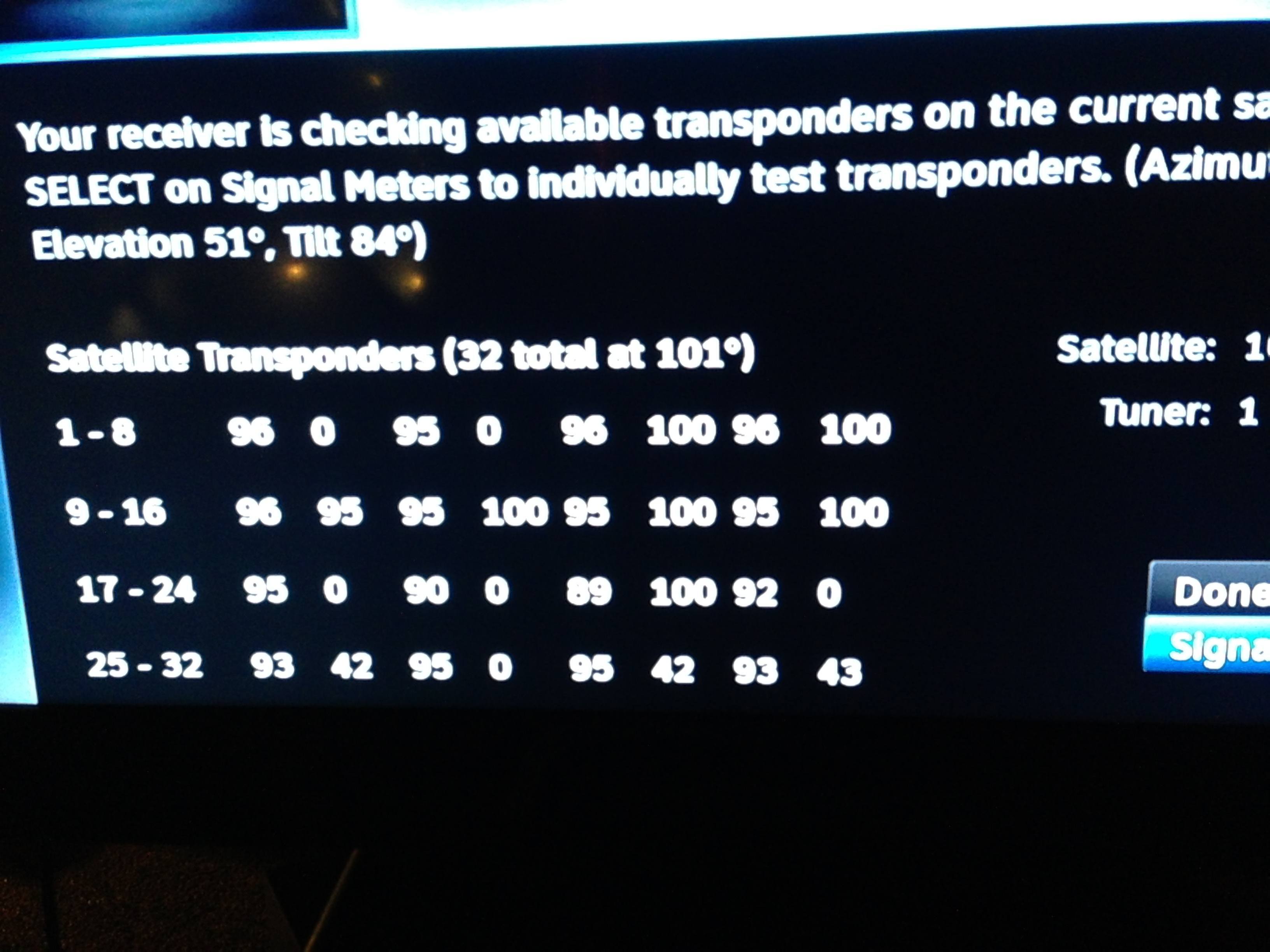

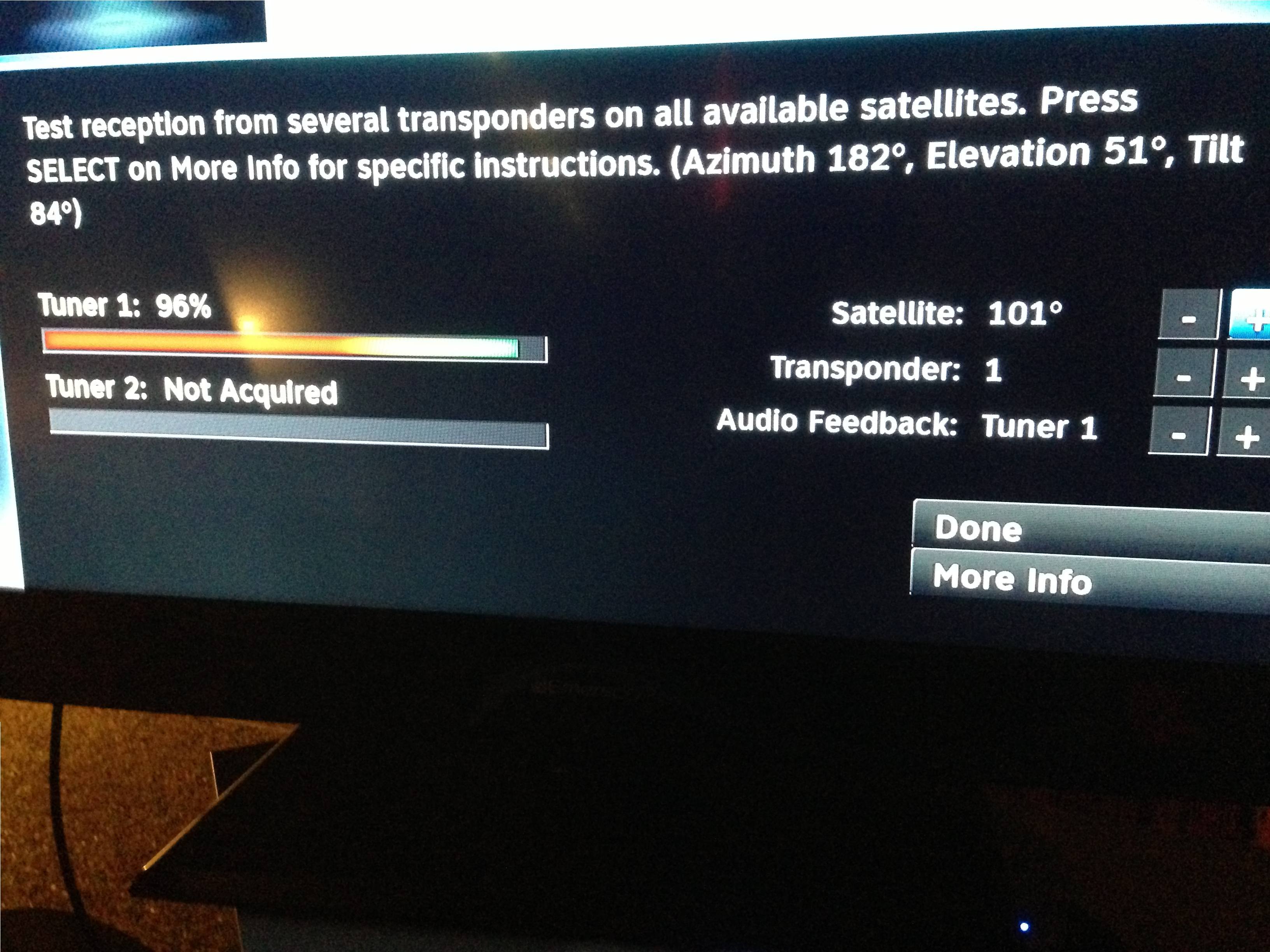

I plumb the pole, dial in the 101 to about 97% on the signal meter via TV. I do not have a handheld meter.

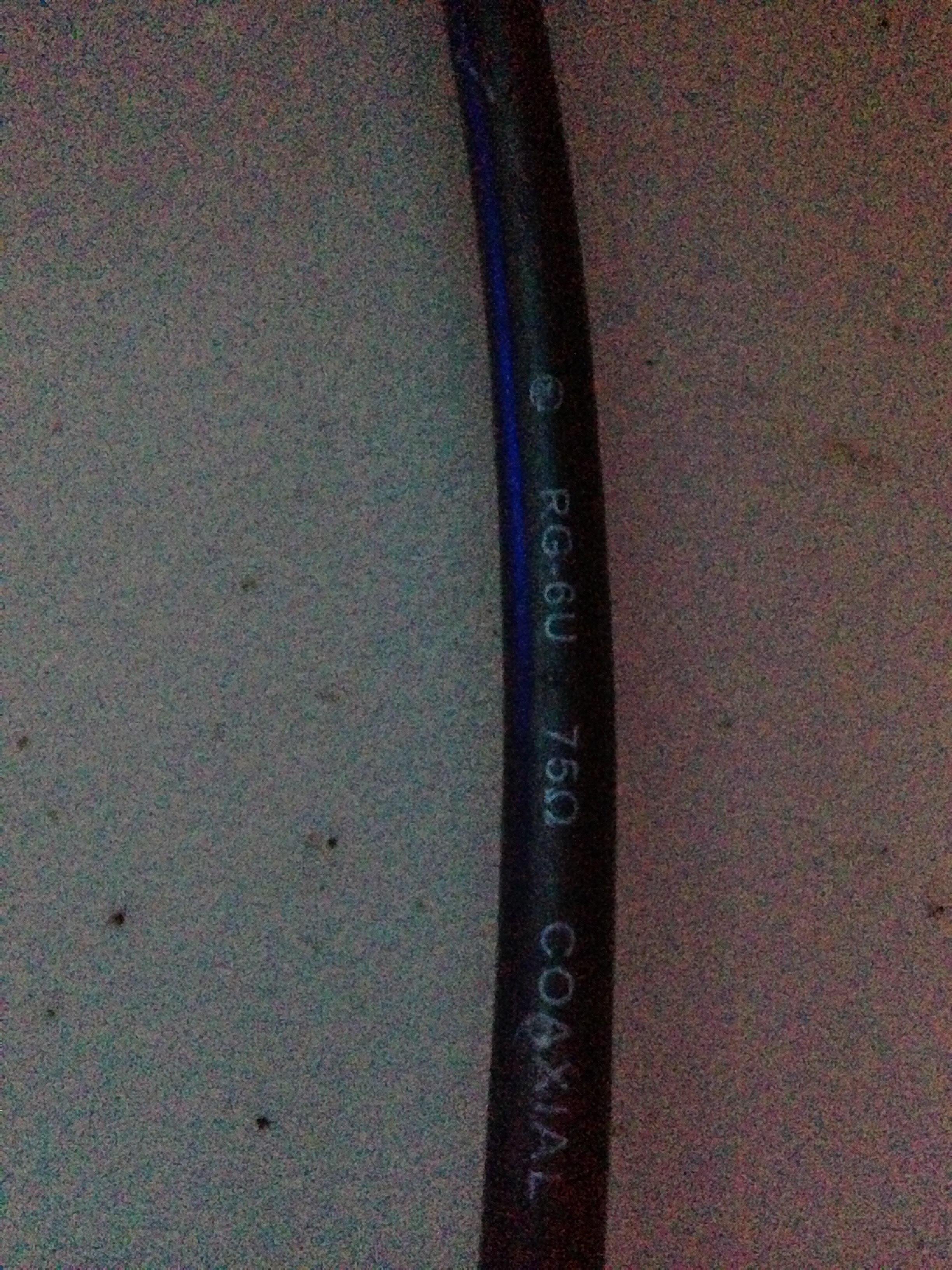

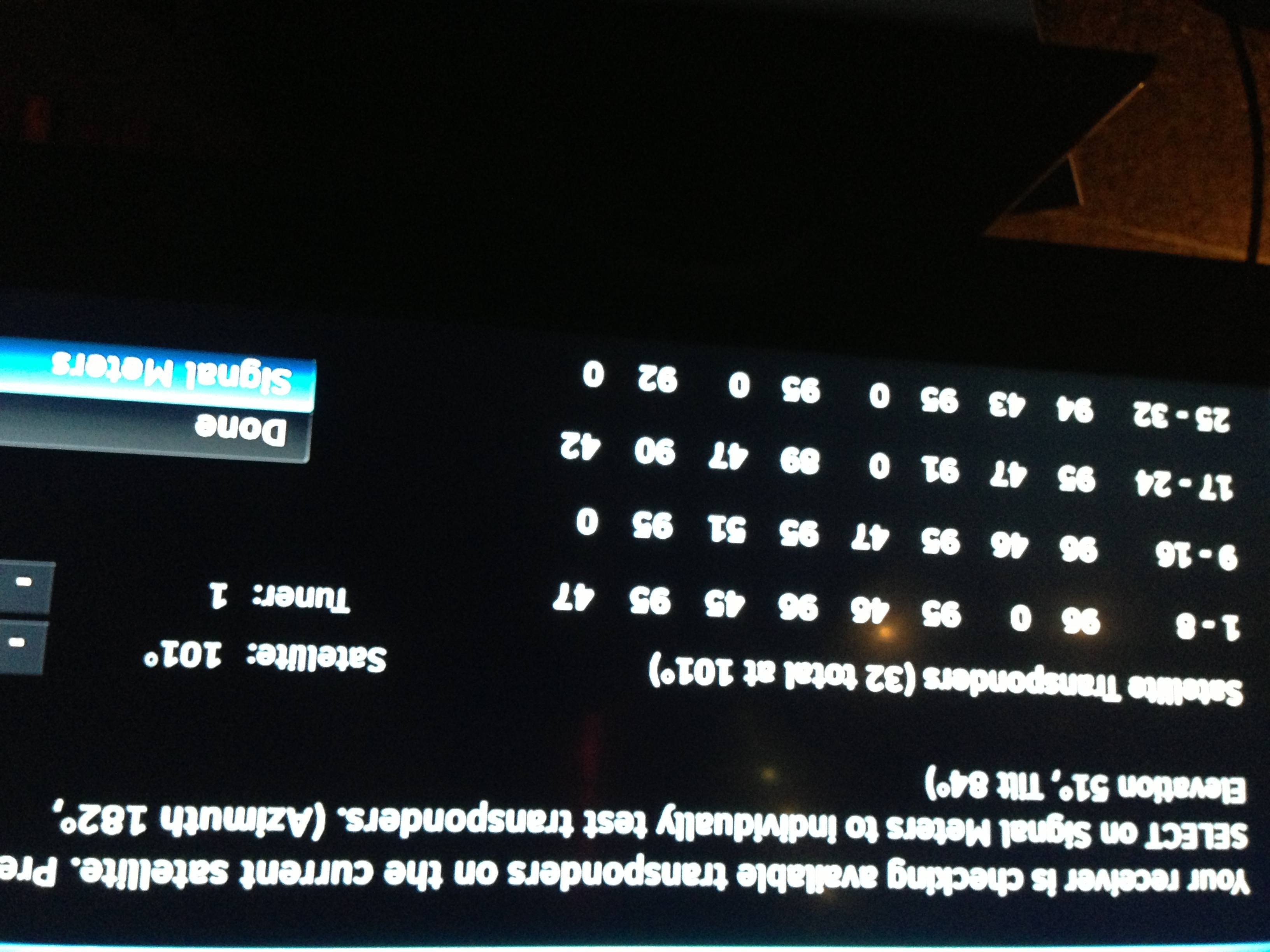

Here's where things seem odd. All of the odd transponders seem about 90%+. The evens are occasionally 45% then jump to 90%+ then to 0%. I don't get how it can have 90% one minute then 0% the next. So I thought maybe it was old cabling but looked and saw it was RG6U cable. I replaced the only barrel connector there and still the same.
Is this a bad LNB? Is it bad cabling? Is it that I'm just not pointed accurately and need to buy a handheld meter? If you have any thoughts please give me your opinion. I've pointed dishes for as long as I've been on Direct but never had this hard of a time. If you are in Dallas and have a meter, I'd welcome your help... Cerveza on me. :)

When you are getting 0s on either odd or even transponders, it's usually the lnb or the cable/connectors. Try switching cables and see if it stays with the even transponders or changes to the odds. If it switches it's likely a cable/connector problem.
Thanks raoul... I hope it is the cable. I just wasn't sure since some of the evens had 100 or high 90's while some were 0 or in the 40s.

Just to follow up on this... I replaced the cabling from the LNB back to the receiver. Works like a champ! I should have done that first thing I guess. Anyway, thanks for helping me go the right direction!
