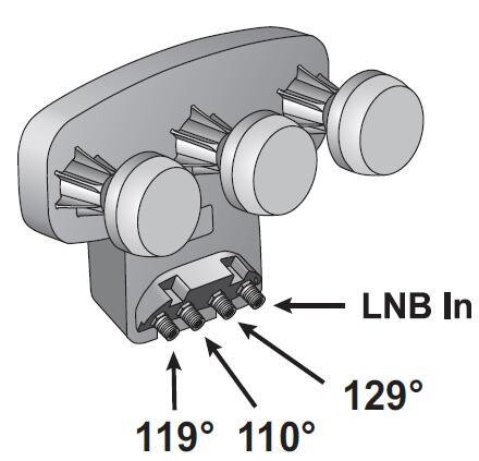

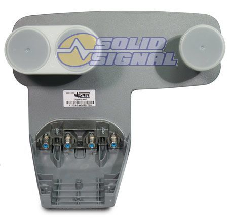

They both fit the 1k4, the latter sees 61.5, 72.7, & 77. The first picture should not be confused with the 1k2 lnb, both look similar other than the fact it states on lnb "1000.4 wa" The other sees 110, 119 & 129. Azimuth, elevation & dish settings vary from region to region. It is imperative to know what birds you can see from your location & if locals are available on ea, wa, or both.
