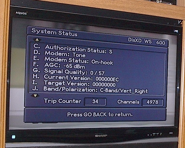

I used a DSR-921 receiver for this test. The DSR-921 is a Canadian version of the 920 receiver.
The 921 was slaved to one of my other receivers which was on W5-700 at the time.
A master reset was done (options-6-7-7-8) then the key for a master reset was hit.
After rebooting the receiver and going to the reset sat limits I then programmed in all the available satellites that were there. They were as follows.
S2 - G6 - S3 – T4 – G7 – X7 – G3 -
T5 – G4 – S4 – W1 – A2 – E2 – M1 –
M2 – G9 – G5 – C3 – G1 – C4 – C1
Since W5 was not on the list I tuned to G9-18 on the 921 receiver since that was on my list of available satellites to choose from.
After a minute or two the 921 received a digital lock on G9-18 and a few minutes later the screen blinked a couple of times. When it did this the receiver no longer was showing G9 but it was now showing (G0).
Channel count from (options- 6-5) after a master rest was 490
The TDT count from Diagnostic screen G (options- 6- 0-5) and use the arrow key on the remote to go to "Diagnostic screen G" top line 5th set of numbers on the top line reading from the left was (520)
After a few more minutes the channel count went up to 719
Using (options- 6-4-4) I noticed that Satellite X0 was added and G9 was added.
Leaving the main receiver on W5 the slaved 921 did not have any other satellite map changes. Not even the W5 satellite was in the receiver.

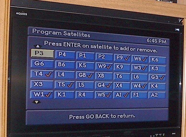

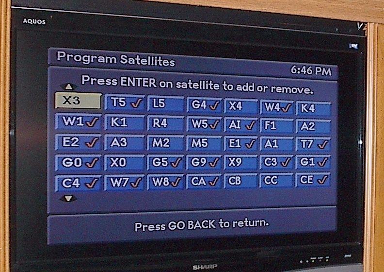

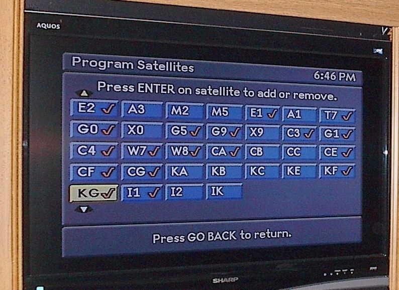

Read all 3 posts before you do anything listed in here.
An hour later I moved the dish to G1-03
I then took the 921 receiver and hit the guide button and immediately hit
(options-6-0-5) this is an old trick used to force the guide info to load fully.
Pressing the guide button then going to the diagnostic screens and staying there the receiver will continue loading the guide till it is full. Diagnostic screen F is where you can watch the guide info being loaded. From the left--- the 4th set of numbers/letters will show a (d); not look directly below the (d) on the 3rd line down, this three digit number will go lower, when it hits 35 or lower then the guide is fully loaded. Depends on your receiver how low it will go.
I arrowed through the different diagnostic screens and I noticed the channel count moving along with the TDT count.
Remember while locking a signal from W5 the TDT count was 520, now on G1-03 after loading up the generic satellites the TDT count jumped to 1745.
The channel count went from 719 to 4641.
After the guide was fully loaded on the main receiver and the 921 receiver I then programmed on the 921 all the satellite icons it just loaded: They were:
P3-P4-P1-P2-P9-K6-B6-K5-W9-K9-K3-L4-T6-L6-X3-L5-K4-K1-W5
R4-E2-A3-M5-E1-A1-T7-X9-W8-
CA-CB-CC-CE-CF-CG-KA-KB-KC-KE-KF-KG-
I1-IK

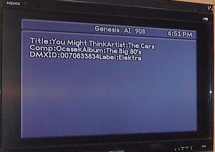

These satellite icons just listed above were NOT being transmitted on W5 (AMC 18 at 105° W) but from G1 (Galaxy 12 at 133° W).
After all this I moved the mail receiver back to the W5 Satellite and the 921 slaved receiver's channel count went up by 5 to 4646.
The AI icon is no longer being transmitted on W5 so that testing is finished.
This means if you do a master reset now you will NOT receive the DMX channels that were on the AI icon!

This is my 4d 922 current status.
My wonder is this. If we have to do a MR to get W5 to run on Comcasts EMM are we going to loose our generics? Motorola needs to give us the maps from G1 with the generics on W5, AI and any additional birds. As you can see I have a ton in my lists. My original download is from Jan 2006, never did a MR since new. Heck I still have X4.
AI icon is no longer being loaded at this time. If you have it then great but after a Master reset of your receiver it is gone.
