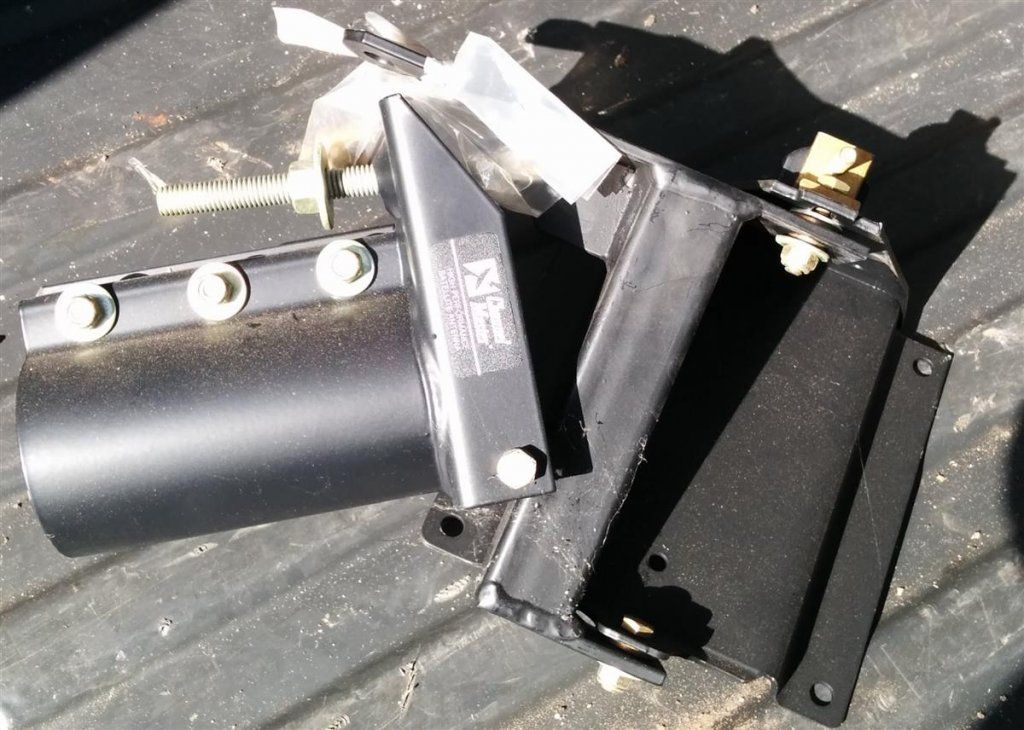

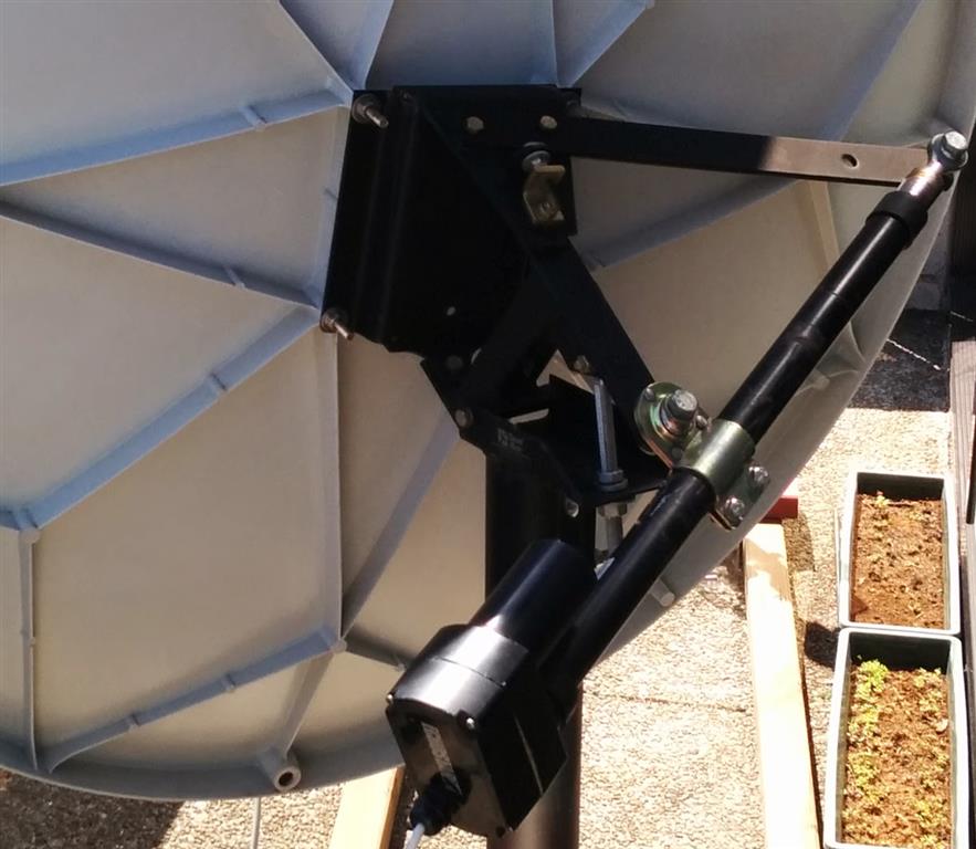

Agree with Titanium: Why invent bicycle and do not use original CM polar-mount? IMG_20150524_140414 (Large).jpg
Agree with Titanium: Why invent bicycle and do not use original CM polar-mount? View attachment 110088
Original CM polar mounts for the smaller dishes (4') are VERY rare in the USA. I have an original one, but it's the only one I have ever seen in the wild. I know people have transplanted polar mounts from other dishes sometimes though.
Here, other side of the pond I see more polar-mounted CM120 dishes than Az-El mounted. On the second hand market such polar-mounted an antennas, if you are patient, possible to buy for 50 bucks. Usually mounts have rust and need some work to be done before installation.
Not in the USA. 99.99% of those types of dishes are ALL fixed mounts. You just don't have a car dealership and such that needs a polar mount on a 4 or 6' offset dish.
We also just do NOT have that sort of FTA stuff available over here, as the robber barons that run corporate America don't want people to know that they can get "free" satellite tv of any sort. So there just isn't enough of a market to make money where that sort of stuff is readily available.
Nice looking mount. I wonder how much wind load from a 1.2m can it handle? I think somebody could sell a bunch of them in the States, if the shipping wasn't out of line.
What would you think adequate price for this polar-mount is (never used)? I mean 30-40 EUR...
Think around 50Eu (or the US Equiv) delivered would be about right. But doubt it would be possible as the demand would be too small to make it profitable. (being it's being shipped/ imported from Europe)
(I'd take one in a heartbeat tho- - )
I am certain that shipping alone from the EU would be approx. $80-100US.
30-40 EUR ($35-40US) for the excellent condition, like new bracket is very fair and on the low side in my opinion. As I recall, these were retail priced over $125+ shipping when new.
