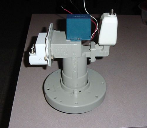

i just bought a corotor plus i bought it because im going to use it on sky 58 west
i posted that dmx741 standard or universal was cheap to me because i skew move and move my 6 foot dish
until i had some quality only 20 percent
i was thinking this corotor plus i bought might be the answer to everything
because it didn't perform to my needs of a sat of this kind so i wil also experiment with other as well
but the thing is i just know how to connect one lnb at a time not like the dmx for two at a time
so i might need some kind of switching. the guy i bought it from also said it has the little blue box polarator
but who know how that works with this
it has these two lnbs and its worth a shot to work with if someone can tell what i can really do with it
or like you said i might as well go with the dmx 741 standard 22khz or universal disqu 1.2
so i have read that some lnbs don't funciton as well as the feedhorn type or so i have read
i am wiling to work the corotor
ASPEN EAGLE 17- K C-BAND LNB AND ASPEN EAGLE .6 DB KU LNB
and it has the polorator blue box with wires sticking out
and looks cool
so kindly i wanted to ask what are my options here
i have a that ws international dish 6 foot polar mount and the 24" acutuator and the vbox-x oh and the fs1 meter
oh and what is the wideband corotor plus and corotoro plus itself

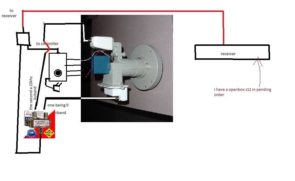

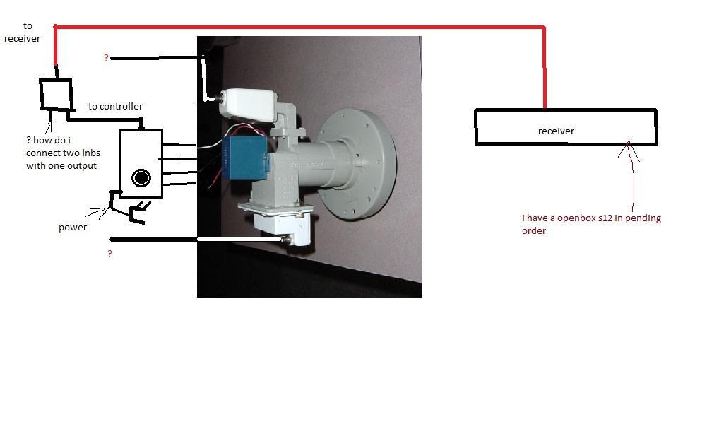

i drew how it would look
this is nice since i can mess with the polarity
but how do i connect the two lnbs to the one input
do i need a diseqc 2x1 Untitled.jpgor a multswitch 2x1
yes 22khz-0
here is the traxis says DiSEqC 1.0, DiSEqC 2.0, 0/22 KHz switching
openbox s12 is DiSEqC1.0/1.1/unicable/1.2/1.3 (USALS) Supportedi bet setup matters for both on the type of switch i use
