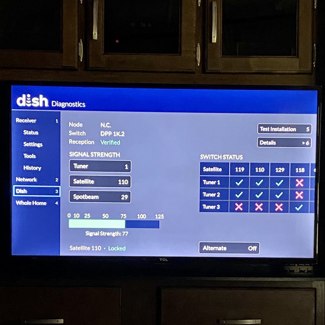

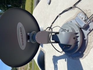

It depends on the satellite you are missing. Most of the HD channels are on 129. If you don't have that one you are missing out on the best image quality. Can you take a picture of your check switch screen and let us see what you see? Now that I look at the Trav'ler pictures, does the LNB have two eyes or three. If only two it is an eastern arc LNB. You would be able to see, probably two of the western arc satellites but can never see the third.

There are 3 eyes. I’ve attached the picture of my check switch.

There are 3 eyes. I’ve attached the picture of my check switch. View attachment 146056
OK, so you are seeing all three satellites, just missing that third tuner. If you are OK with what you have all would be fine. But, if you want all three tuners you’ll need that solo node. You would want to place that node somewhere near where your receiver coaxes come together. Your 211 is, as been mentioned, a bit more problematic. To continue to use it along with the Hopper and the Solo Node, you would require a 44 switch. If you are using an external hard drive with that 211 today it would make sense to add the 44 switch. If not, maybe instead of purchasing a 44 switch you could purchase a Joey 3 and use it in place of that 211. Things to think about.
