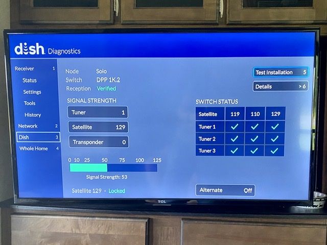

If a Joey is in the future it would probably replace the 211. All that would need to happen there is to take the coax off of the 3rd port on the Trav'ler and move it to the Client port on the Solo Node and, of course, change the receivers.
I get it! It is so great when the light goes on! I am awaiting my solo node and cables I ordered off amazon, then I will let you know how it goes!

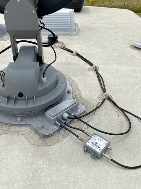

I received the solo node (thanks Bobby!) and the cables from Amazon and mission accomplished! Thank you everyone for making this so easy! I now have all 3 tuners and my daily switch check is behind me!

I received the solo node (thanks Bobby!) and the cables from Amazon and mission accomplished! Thank you everyone for making this so easy! I now have all 3 tuners and my daily switch check is behind me! View attachment 146212 View attachment 146213
TBoyer, now that I look at your second photo, it would be a good idea to secure your extra wiring and the Solo Node to the roof before moving your RV. Flapping in the breeze will cause issues later.
Yet another reason why I recommended putting the Solo Node inside the RV, but who listens to me? :oldwink
If you look at the installation you will notice that both receiver coaxes enter the roof of the RV in the same place. They will be hidden in the ceiling of the RV and home run to the rooms. It would be difficult to place the node inside without tearing apart the interior. This installation works and is the least work intensive and has the least cost. It is not a big thing to secure the items on the roof.
Thanks, I appreciate your input. I haven’t figured out how I’m going to secure it yet. Any input from the RV folks out there would be helpful. I will research and figure out something before we get back on the road.
You could try 3M Command strips (or tape). Just make sure you thoroughly clean (and dry) both the Solo Node and the place on the roof where you are going to attach it, before sticking the double-sided tape there. This should hold well enough, at least as a temporary fix.
That would rip loose in a flash with wind streaming over the top at ~65mph. I note that the existing wiring seems to be in wire clamps that may or may not be screwed into the roof and then covered with a sealant. It might be good to go to an RV repair shop and have it done professionally. It can’t cost much.
