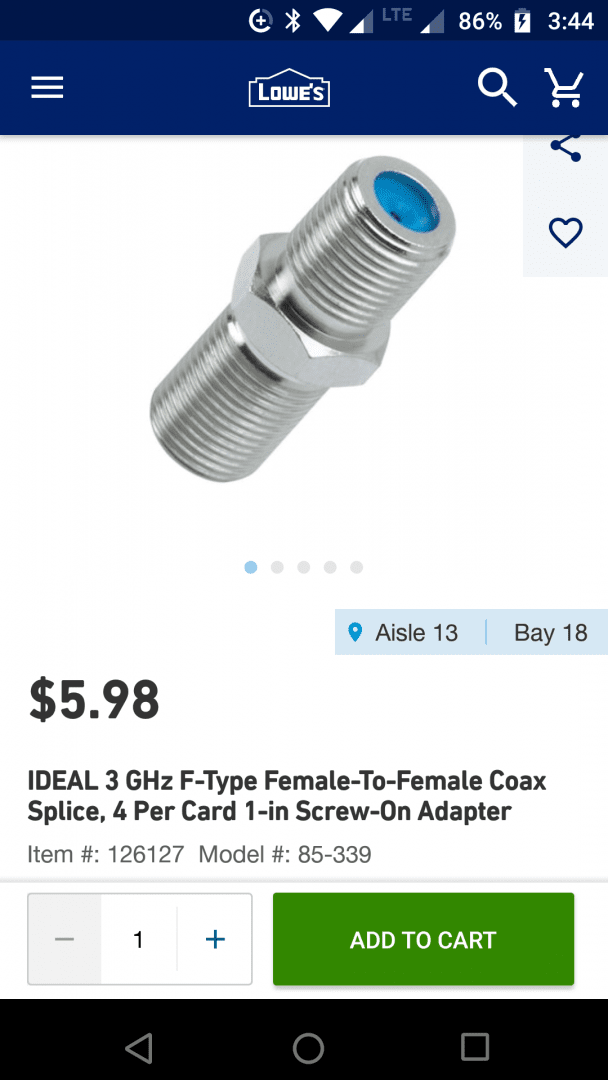

Ok will do, thanks. I googled what a swm splitter is and it does have that type of splitter further down the side of the house from the dish. Then there's the regular style splitter closer to the dish (5 ft or so from the LNB). Where is the best place to buy a barrel connector?
My local Lowes store has them in stock

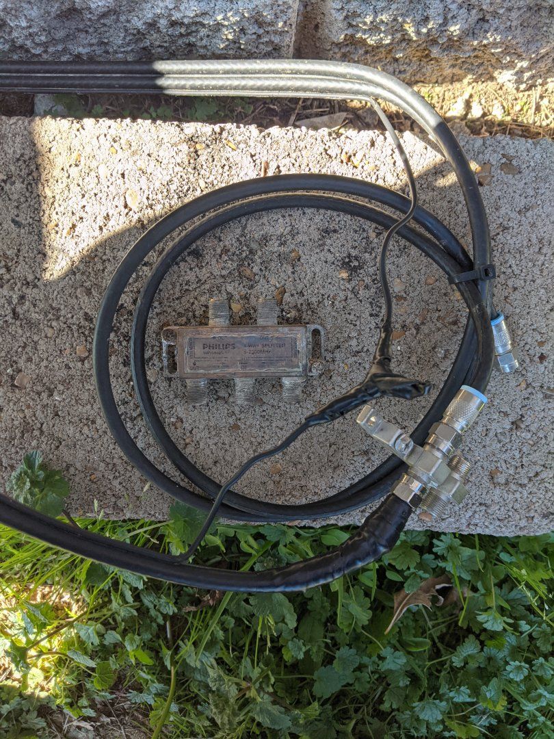

I have an extra 4-way splitter from my old house...could it work for the job? If not, I'll go into town one day this week and get the barrel connector. I removed the swm splitter this morning (it was located about 10 ft from the dish)...nothing has changed on getting signal. This left one unused cable running down from the power line (guess this was a Direct TV thing).
I'm wondering now about the existing splitter at the dish. The coax coming off the dish is a dual line RG6 so how do I hook these 2 connectors into a splitter when there's only 1 "IN" on the splitter? This leaves one cable unhooked on the dual line at the dish and that's surely a problem on getting signal...but it was my only option, at the time, for the existing splitter at this location. I've attached a picture. It also shows the extra 4-way splitter from my old house that I wanted to use in this location but there's only 1 "IN" for the dish cable.
