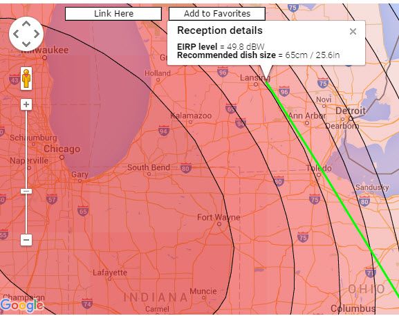

Is this worth pursuing...Marked my location. I was up on my roof and the prior Dish installation from the last owner was Eastern Arc. My channels are on 61.5 Spot Beam 55. I used the Satellite finder app and don't think Western Arc is an option for me due to trees, even though the spot beam would be better. Here's what the 61.5 Spot Beam 55 looks like for me for reception:
I checked the channels on the spot beam for any overlap and they are in use in WV and NJ. NJ spot beam 2 gets no overlap at all in my area. The WV spot beam 32 is the last bit of fringe. I'm thinking I have a decent chance at least?

You are right on the edge of the Chicago spot beam.

Sounds like the only way I'll know for sure is to try it and hope for the best. Based on this map for the Eastern Arc which is how they will install here in Lansing I should have a decent shot at it.
