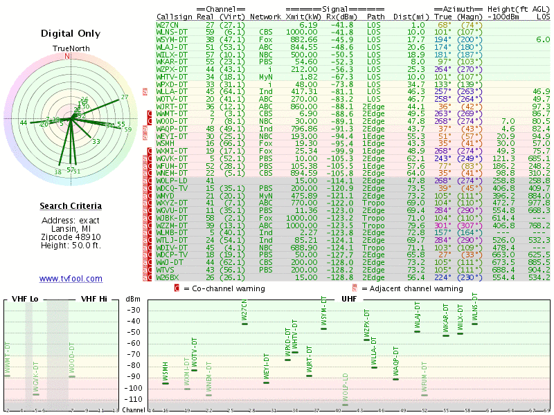

How close to the towers are you? You could be suffering from multipath interference.
According to TVFool, the distances for my 4 major network locals vary from 10-20 miles. I'm a little suspect of that, however, as I'm fairly sure that my local Fox station is less than 5 miles from me. They could have moved their broadcast location, however. I've included my TVFool report if it's any help.
Wow! Your channels are all over the place. What degree are you primarily aimed at? I would have to say that the Dish OTA is a peculiar piece of equipment and it probably is having a hard time with your location. You probably need to jump over into the OTA forum and see if someone else near you can tell you which antenna will serve you best to clean up the signal so your dvr won't choke on it.

I also noticed that you are 1 mile from a transmitter. As you have found out, the newer tvs are better able to handle the interference problems. The Dish OTA card is not so smart. You might need to combine the signals from two very directional antennas. Somebody in the OTA forum should have a better idea.
According to TVFool, 3 of your stations (Fox, NBC & ABC) are within 20 degrees of each other. I assume that your antenna is pointed at 181 to 185. This means that CBS is at a 80 degree angle to your antenna. No wonder you have reception problems. What antenna are you using? You may have better results if you aim your antenna towards 190 - 200 and pick up CBS from behind.
