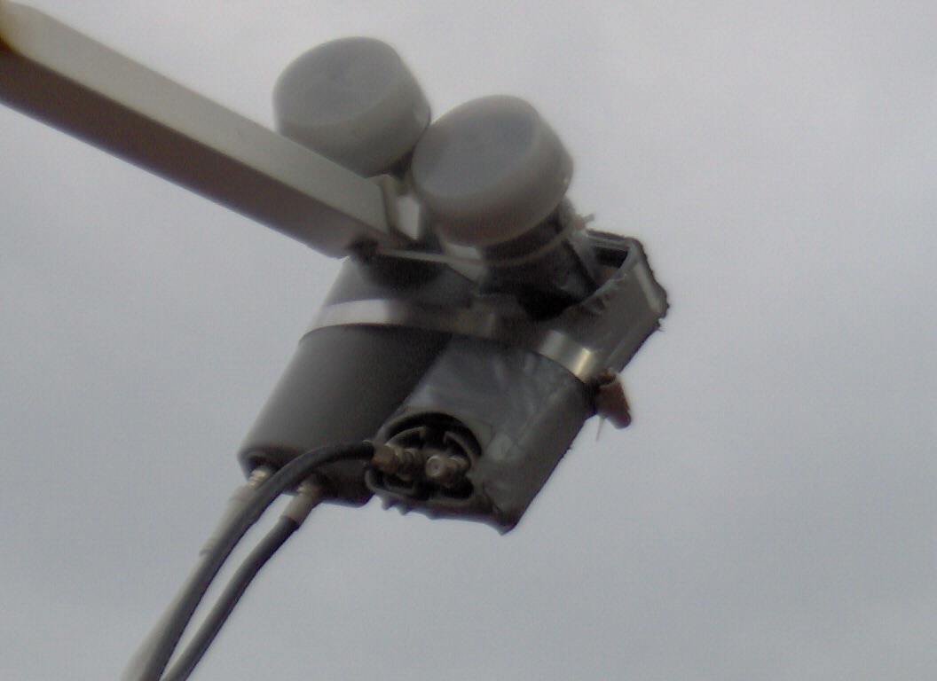

If you are behind the dish if you put the DBS LNB to the right of the KU, it will be -5 degrees. If its to the left its +5
As an example, in the below picture this is 123 & 119..the DBS LNB is the closer one (with the duct tape on it) :)
you can have it on either side. My main motorized the DBS LNB is on the other side so I can get over to 148 (16 elevation in MN). If it was on the right side (as in the above) the LNB would hit the roof...on the other side it doesn't
If it were on a fixed (not motorized) dish, you'd have to put it on the side that Iceberg has his (assuming the Ku is for G-10R at 123w and the DBS is for 119w). A DBS satellite to the east of the Ku satellite would be picked up by a DBS LNB mounted west of the Ku LNB.
