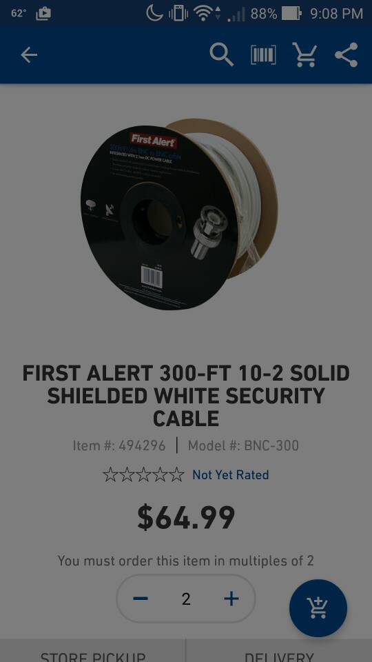

Thats a good deal for RG6 at ur local Lowes..Don`t recall such a deal here at the local Lowes stores...Just a suggestion but the compression fittings that you posted do not have orings which will help in keeping moisture out...Beldon I have had good luck with here.
About once a yr I go thru all my compression fittings for every lnb in the yard...The Beldons always look fresh when I disconnect and inspect..Majority of time if I see any corrosion it is of various brands and I just cut,resplice and put a new fitting on.

Appreciate it, I wasn't considering them, just making sure that I found the right ones in general, I'll make sure to get some of what you suggested. Appreciate the first hand knowledge

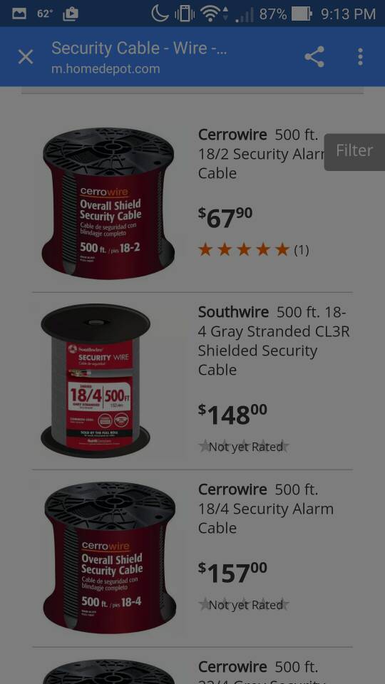

Sensor wire- 2 wires plus shield, 18-22 gauge stranded. Available at Home Depot, marketed as alarm wire!
Which would you recommend is best?
