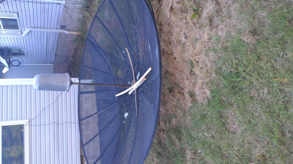

Cleaning up and mounting a BUD
Your line of sight, with no trees, buildings, etc,should be around 30W to 137-139W. Having said that,I would start by focusing on 87W to 107W. The ones I personally watch a lot are 97,99,101,103, and 105W.
Finally got on my laptop and looked at the dishes on a bigger screen, lol.. According to diahpointer.com
I can see from 30w to 139w with the closet obstacles being 50ft(+/-) trees well over 200ft away, according to the site that is so guess I'm doing good on that part...

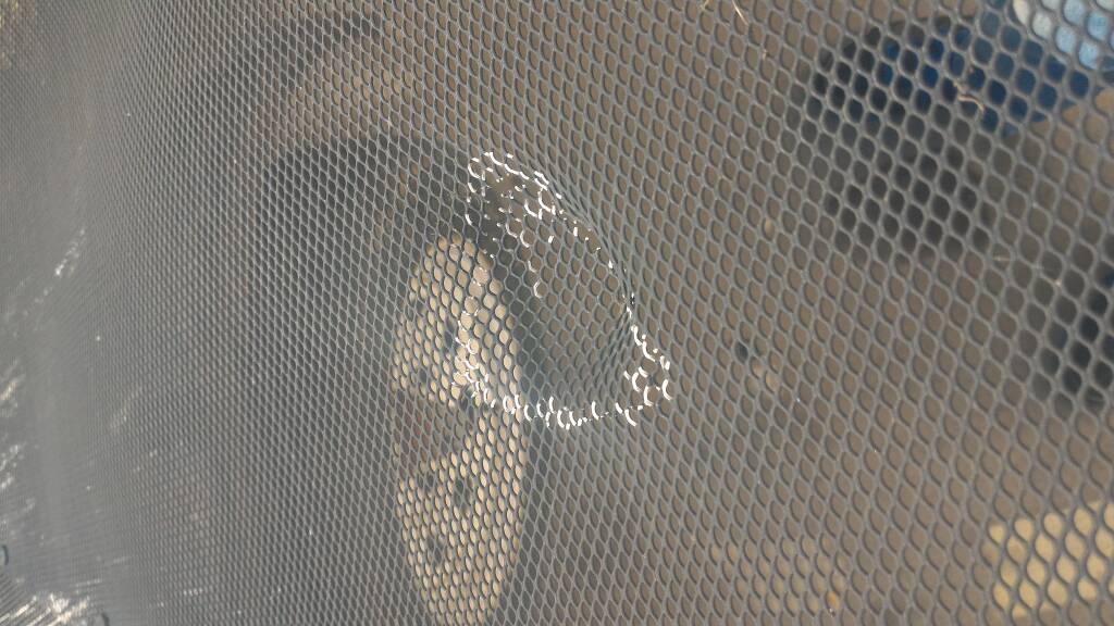

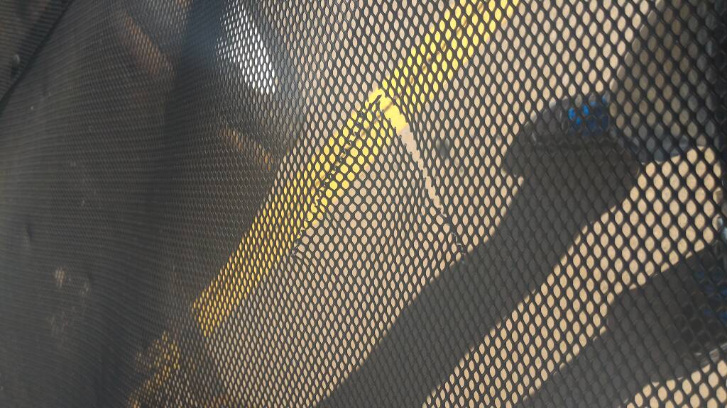

So I got the other dish, looks like a 12' everything looks good except for the two tears on the outer edge of the mesh...
will it effect it, or should I replace / repair?
Sent from my ASUS_Z00AD using the SatelliteGuys app!
Just straighten them out and stitch it up with some small gauge metal wire.Blow on a little black paint and it will be practically invisible.Shouldn't take but a few minutes and you'll be good to go. :thumbup

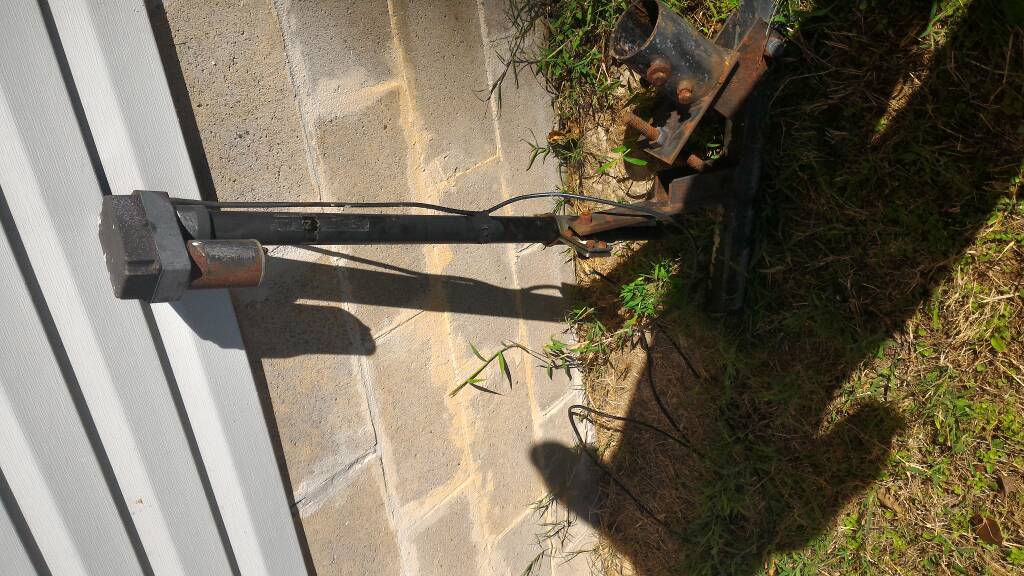

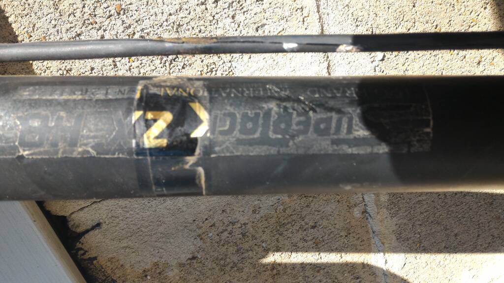

The second dish's actuator looks to be in far better condition then the first one.. How do I go about checking it to see if it works and cleaning it up, it's a super jack (what's listed on the side)

You can use a car/motorcycle/lawn tractor/power tool battery, or a DC power supply of say 12-36 volts and sufficient amperage.
Hook to the motor power wires, reverse polarity to reverse direction.
Do not apply power to the sensor circuit.
Reverse polarity? Positive to negative lead and negative to positive lead? I have a CHARGER for those types of batteries, but none of those batteries anymore, would it work?

Yes, hook the wires up one way to extend the arm and reverse to retract.
Yes, most chargers will work, some of the newer "smart" ones may act funny, but that should work too.
