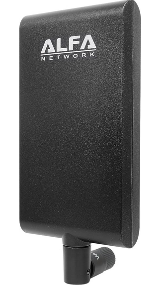

If your router has external antennas. The Alfa patch antennas DO work and help beam Wifi in the direction of the remote streamer, TV.
