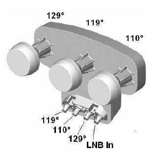

Make sure that you have the cable connected to the right "out" port on the LNB (if it's in the wrong port, it will not show when using the DPP44). If you bypass the switch, and run a cable straight to the receiver, the internal switch on the DPP LNB is probably kicking back on, which is why it can show up when you run a cable directly to the receiver, but not when using the external switch.

To me, it sounds like the cable for what your using to get 61.5 is connected to the wrong port on the LNB
If your using the 119 LNB to bring in 61.5, make sure it's connected to the 119 port. Same for 110 and 129
