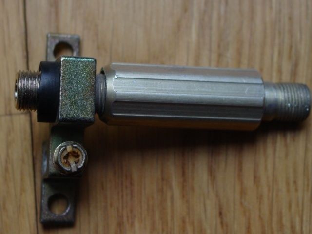

Anyone ever see this thing? This coupler has my home cable on one end, and the other end is connected to my satellite. The long piece on the right side didn't used to be there. And coincidentally, I cancelled Comcast this week. I'm thinking that Comcast put this thing on the coupler to prevent me from connecting the loose feed from Comcast, but instead, it's preventing me from connecting to my Voom satellite.
If you've seen the thing, can you tell me how to get the darn thing off the coupler? I don't think my local hardware store sells couplers like this, or I'd just replace the whole thing...

That is a ground block (thats not even grounded)
Don't even fight with it, just get another ground block you can get them anywhere for about a buck. :)
The device is called a locking terminator. It can only be removed with a specialized tool that turns the device from the inside. It's completely passive, but it will block signal in both directions. You're probably the victim of a installer or technician that can't tell a cable connection from a satellite connection. Replace the whole thing.

AS was mentioned that is a locking terminator Comcast especially are major wanks about it, they tell their subs to put it on everyone and be an annoyance to people canceling them for Sat. If you call Comcast they will tell you they installed all those lines and if you need service to call your Sat. company. I say you buy the tire locking terminators and slap them on the car of your local Comcast manager.

Thanks. Went out to Radio Shack, spent 5 cents and all is working now.

Thanks for your advice. I was able to remove the whole damn thing and replace it with the Radio Shack unit. I bought a spare just in case I can't cancel the Comcast appointment and the same knob comes out and does the same thing again (I've been with Comcast long enough to know what to expect...).
