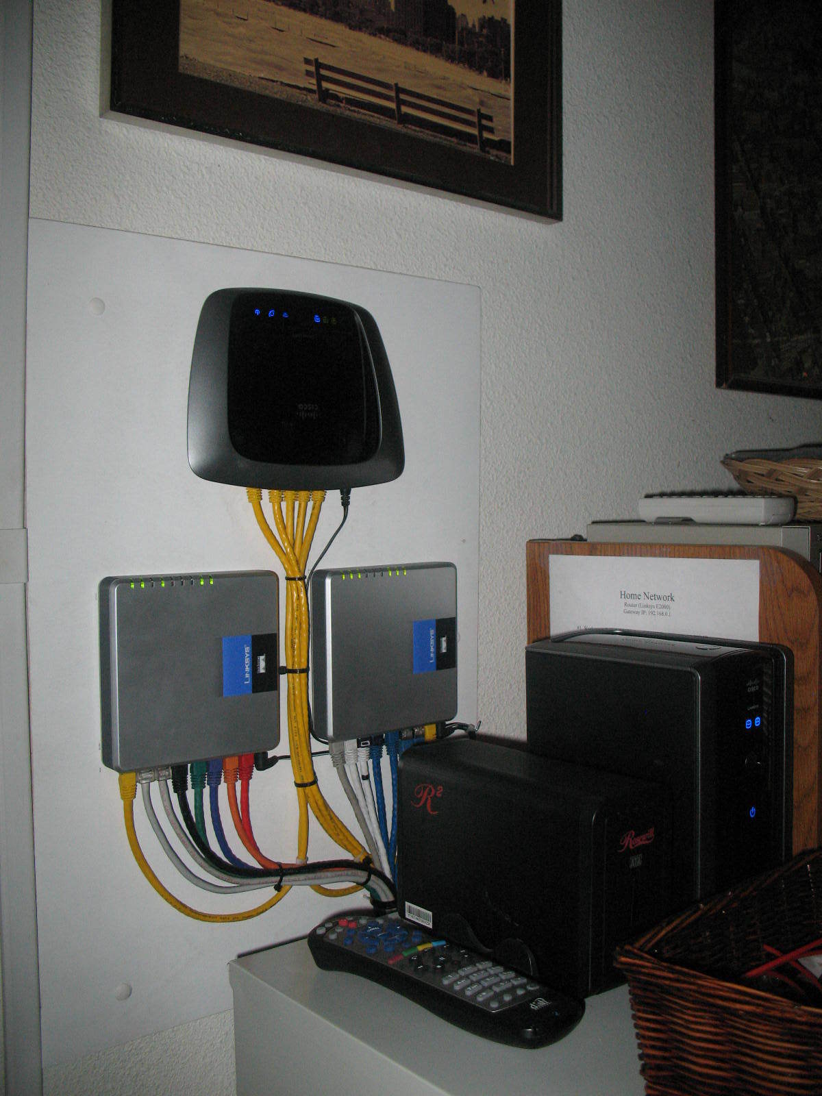

I upgraded to gigabit LAN using Linksys switches and router. I have the 722k hooked to it, also the slingbox.
