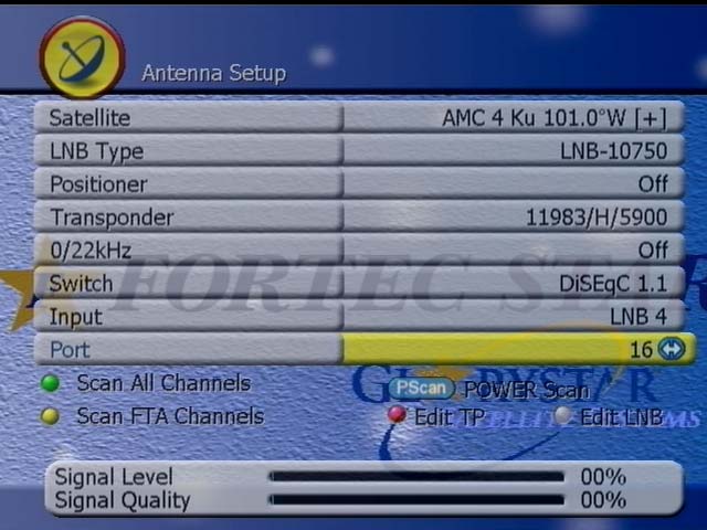

Does the setup menu allow for more than 4 ports on a diseqc switch?
Many receivers advertise that they are diseqc 1.0, 1.1, and 1.2 compatible yet only allow for 4 diseqc ports in the satellite setup menu.
Fred
The Fortec Mercury II supports:
  • DiSEqC 1.0 - 4 ports x 2 (22KHz) = 8 LNB combinations
  • DiSEqC 1.1 - 4 ports x 16 cascaded DiSEqC ports x 2 (22KHz)= 128 LNB combinations
ird -> uncommited 8x1 -> commited 4x1 -> 22khz -> lnb
1 x 8 x 4 x 2 = 64
I dont think you can cascase uncommited switchs behined other uncommited switchs, but I havent tested, Ive really needed too lol. thats ALOT of lnbs, haha.
I didn't think you could use 2 diseqc switches with each other? I'll have to try that out, with some of the 20 @ 4x1's diseqcs I just got from the SatelliteAV deal.

OK after taking another look, I see it's a 8x1 uncommitted diseqc, and the ones I have are 4 committed and 4 uncommitted in the 8x1. So I guess I could try the 4 uncommited ports of mine?
sure you can. You can put a committed switch on a port of an uncommitted switch. I have a 4x1 on a port on my digiwave 8x1 uncommitted for 11 LNB's on the Visionsat
to get 128 LNB
receiver----uncommitted 8x1-----each port has a committed 8x1----22k---LNB
8 ports-----64 ports----128 ports
setup would be a pain because the committed switch you'd have to do motor setups and not just diseqc
