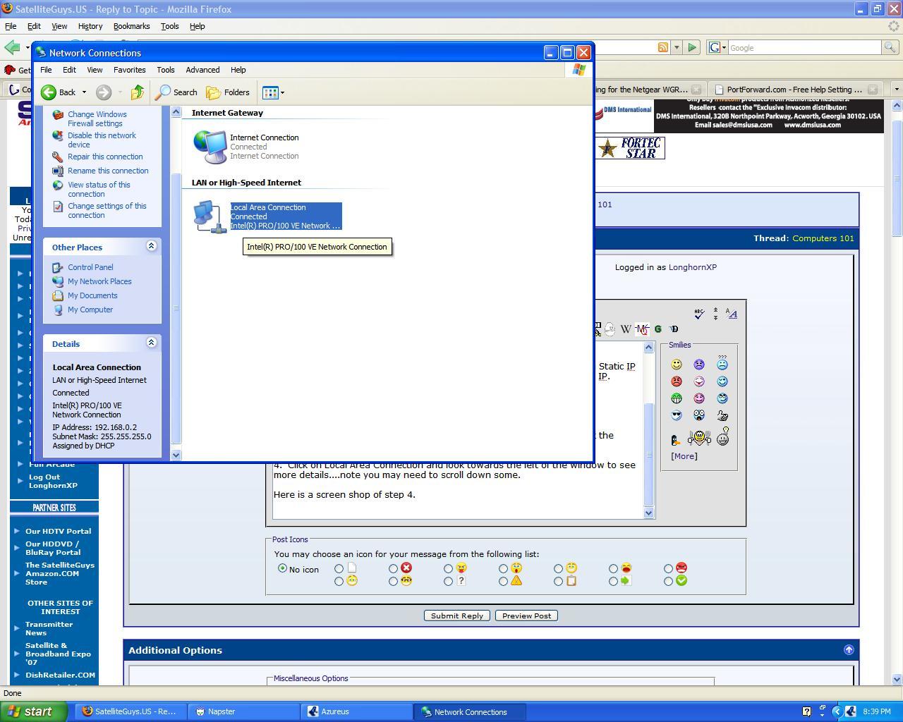

If your control panel is in classic view skip steps 1 and 2 and double click the Network Connections Icon.
4. Click on Local Area Connection and look towards the left of the window to see more details....note you may need to scroll down some.
Here is a screen shot of step 4.
http://www.satelliteguys.us/attachment.php?attachmentid=16878&stc=1&d=1181178522
In my case it says in the screenshot assigned by DHCP. Even if your computer doesn't say this I'd suggest you follow the next steps either way.

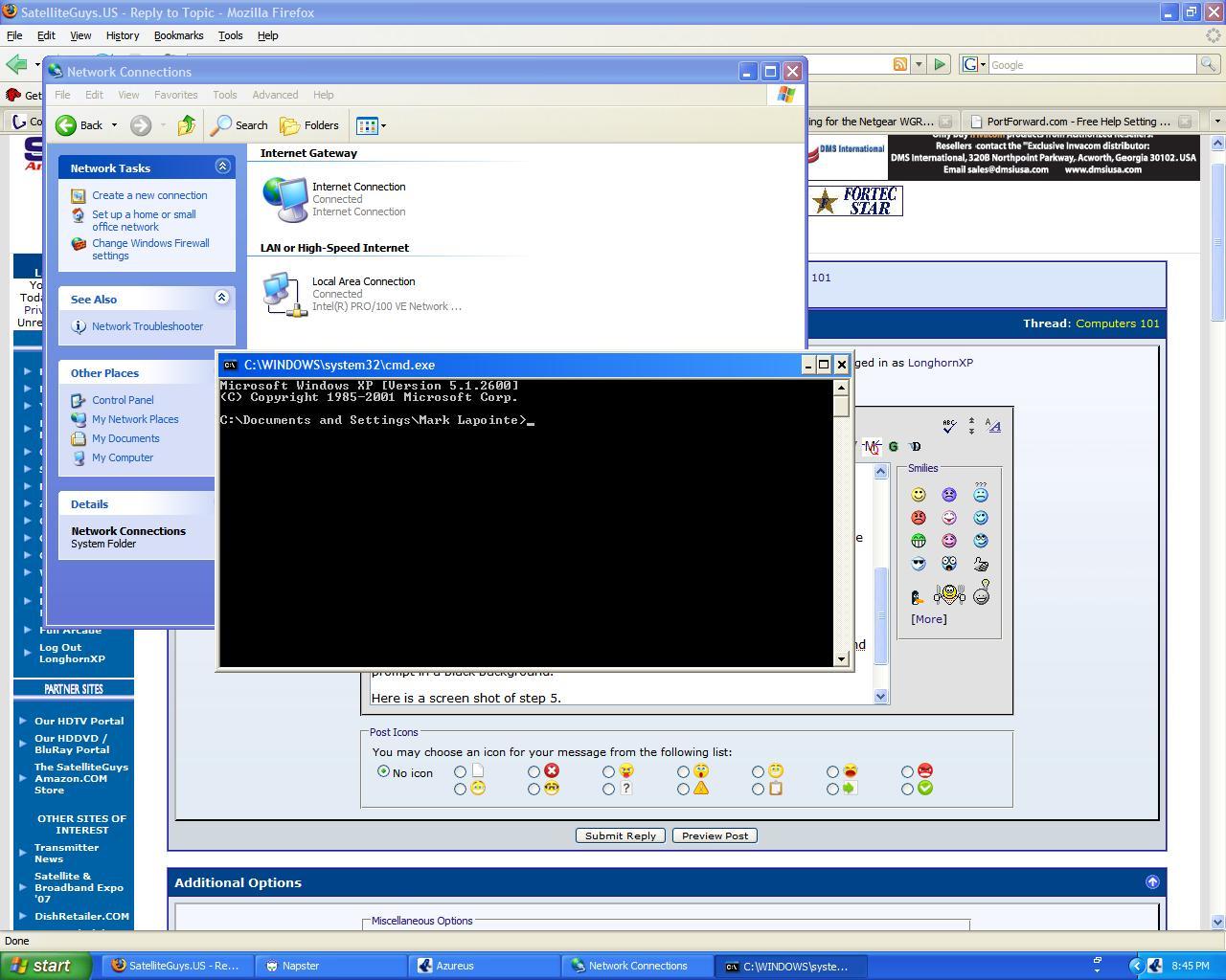

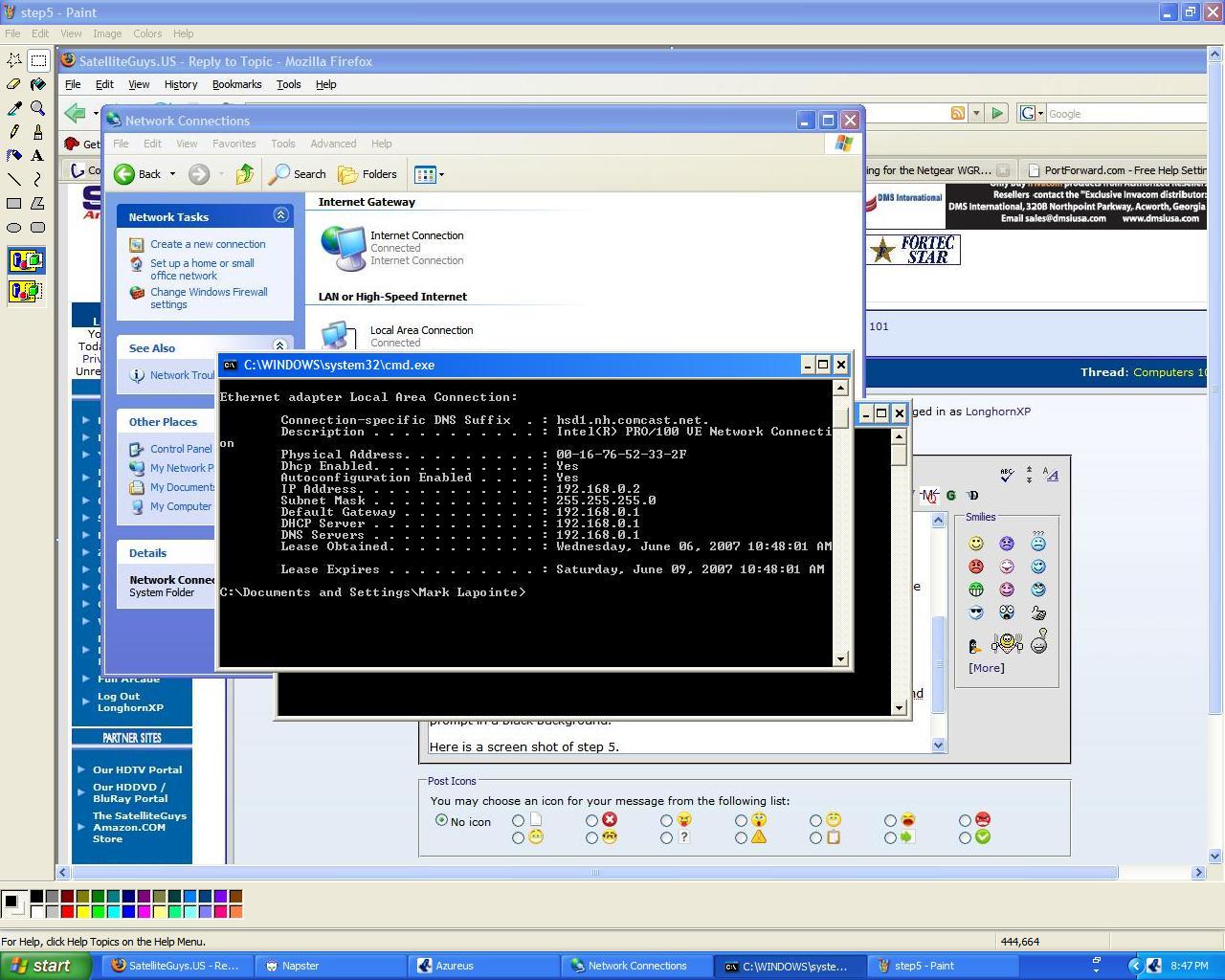

5. Click Start and next click Run. This will bring up the RUN dialog box. Enter cmd in the run box and press Enter. This should bring up a command window with a prompt in a black background.
Here is a screen shot of step 5.
http://www.satelliteguys.us/attachment.php?attachmentid=16879&stc=1&d=1181178522
6. Type "ipconfig /all" without the quotes.
Here is a screen shot of step 6.
http://www.satelliteguys.us/attachment.php?attachmentid=16880&stc=1&d=1181178522
7. Now write down on paper the following information but note the results for you may be different and most likely will.

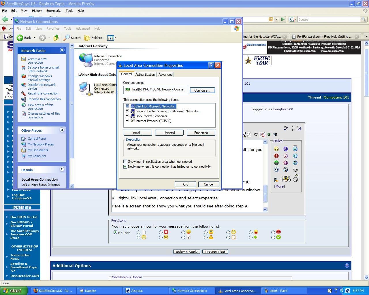

9. Right-Click Local Area Connection and select Properties.
Here is a screen shot to show you what you should see after doing step 9.
http://www.satelliteguys.us/attachment.php?attachmentid=16881&stc=1&d=1181178522
You should see the Local Area Connections Properties Dialog box after finishing step 9.

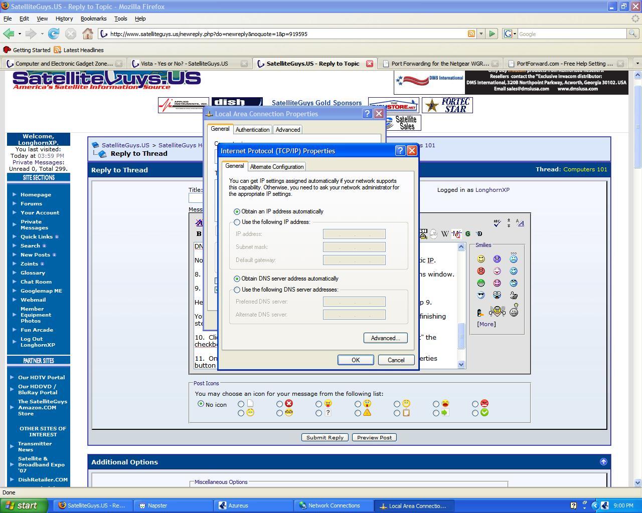

10. Click on Internet Protocol (TCP/IP)....Note click on the text and "not" the checkbox.
11. Once Internet Protocol (TCP/IP) is highlighted in blue click the Properties button just below it.
Here is a screenshot showing what you should see after finishing step 11.
http://www.satelliteguys.us/attachment.php?attachmentid=16882&stc=1&d=1181178522
12. Fill in the information your wrote down on paper into the proper fields within the Internet Protocol (TCP/IP) Properties Dialog box.
Here is a screenshot showing everything filled in correctly but note the information you wrote down on paper may differ so use "your" information and not mine okay.

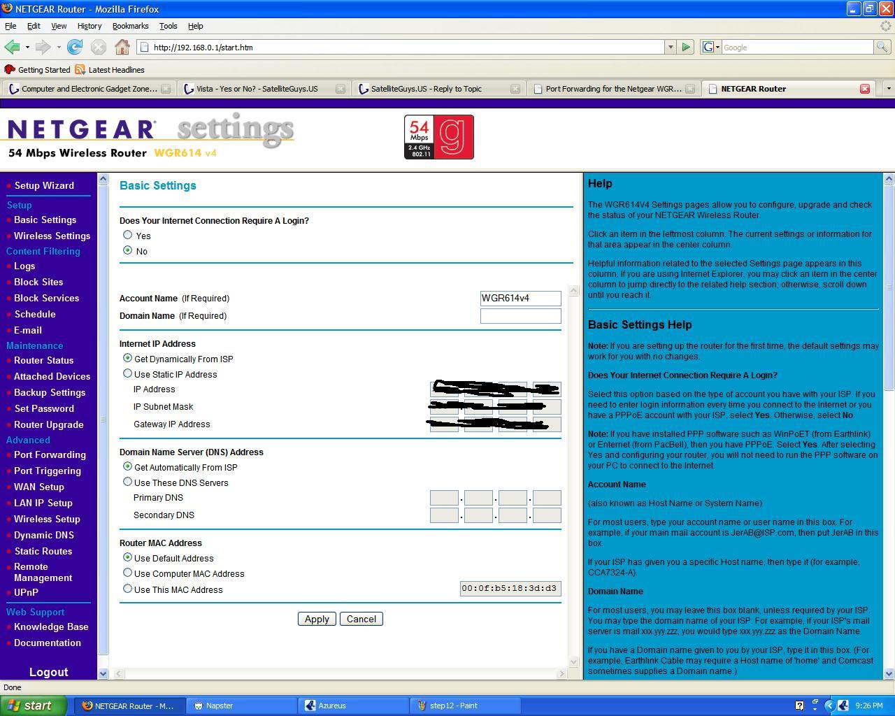

In my case I have a netgear WGR614v4 router so I just need to enter into my browser the following below.
http://192.168.0.1
Here is a screen shot of step 1 for my router so note your router may vary.
http://www.satelliteguys.us/attachment.php?attachmentid=16884&stc=1&d=1181180838
You may need to enter the username and password. If you haven't changed them look in your routers manual for the default username and password. In my case for my router the defaults are admin (user name) and password is the password. Of course my password has been changed from the default.
Now that I'm within my Netgear control panel this is what I see in the screenshot below.
I blacked out the IP address and such that were provided by my ISP for security reasons.

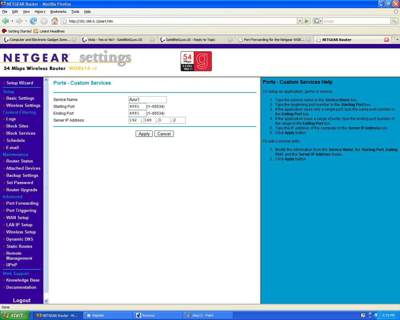

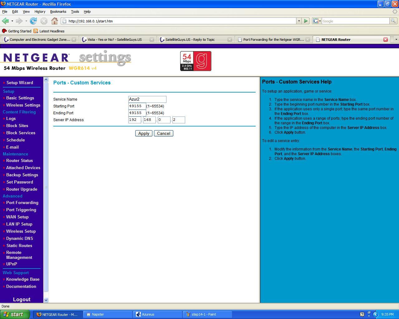

14. On the left hand side I clicked on Port Forwarding. Once the port forward page is loaded I would click the button that says Add Custom Service.
To setup Azureus I need to create two custom services with the following information entered in for each service.
Custom Service 1
Service Name = Azur1
Starting and Ending Port = 6881
Server IP Address = 192.168.0.2
Custom Service 2
Service Name = Azur2
Starting and Ending Port = 49155
Here is a screen shot of both Custom Service 1 and 2 below. Just click Apply after entering the information for each service. Once done I would just click the logout button.
http://www.satelliteguys.us/attachment.php?attachmentid=16885&stc=1&d=1181180838
http://www.satelliteguys.us/attachment.php?attachmentid=16886&stc=1&d=1181180838

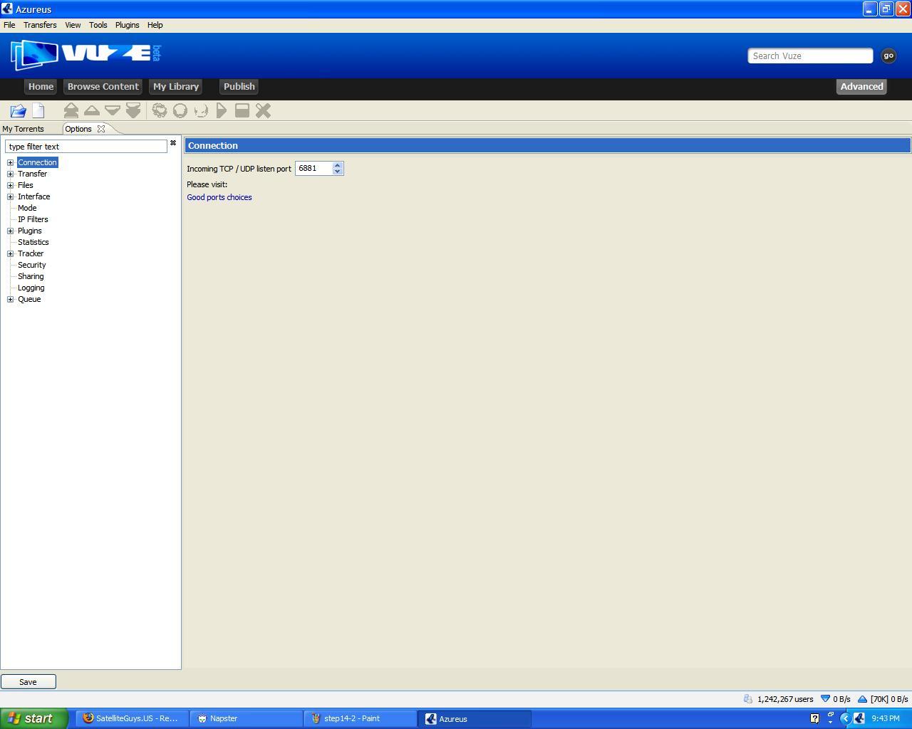

15. Launch Azureus (latest Vuze version). Click the advanced button towards the top right hand side of screen just below the search box.
Now click on Tools....Options and this should bring up the port box on the right hand side.
The box you want should say Incoming TCP/UDP listen port to the left of it.
Enter 6881 in this box if not present. If you still cannot download a torrent and getting the green face thing than your ISP has blocked port 6881. In this case instead of entering in 6881 just enter the other port number your created under Custom Service 2 which would be 49155.
Here is the final screenshot below.
http://www.satelliteguys.us/attachment.php?attachmentid=16887&stc=1&d=1181180838
