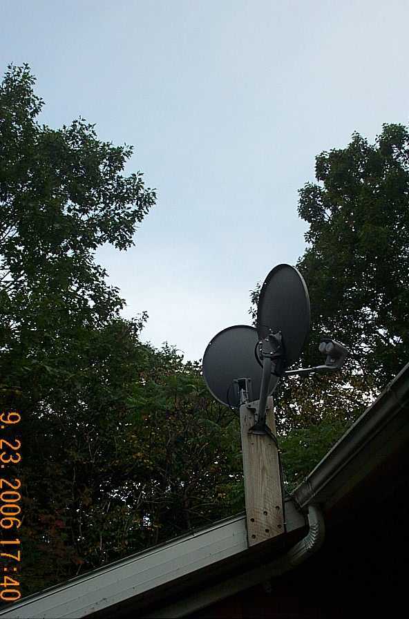

For giggles and grins, look at what I'm looking through for my 61.5. (I haven't actually taken measurements, but when I triangulate 22 deg. off-axis vertically it appears that I'm looking right at the tops of those trees!)
