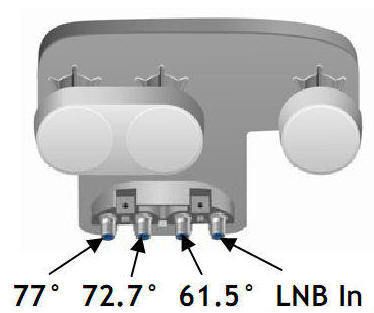

If your Dish is a 1000.4, it would work for Eastern Arc but you would need to switch the LNB to an Eastern Arc LNB like the one in the photo below. Honestly I don't know how anyone is able to hit 129 from NC.
