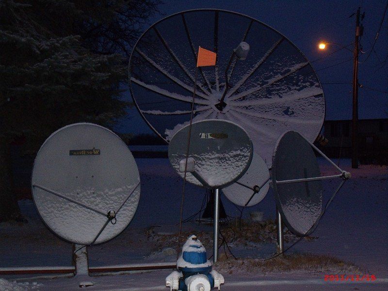

In your above scenario, you could substitute "THEN:' for "OR:". or there's another possibility: the dish may be a good performer on Ku as well. ??? Any brand name - model?? Maybe some pictures would help in that regard. Plenty of folks here have their BUD's outfitted with a dual band LNBF. Although, it's a bit of a trade-off in performance. I use dedicated Ku dishes. One mounted to the BUD to track the arc.

I like your idea of putting the ku dish on the C-band dish. Doesn't it throw the the path of the arc up a little bit, since it is mounted of the edge of the C-Band dish ?

It's a heavy duty 10ft all steel dish so the little 30 incher didn't move anything. Think a metal 36 or 39 inch ku would work on a well constructed aluminum dish. They aren't that heavy. (i may upgrade next spring)
We'll be here to answer any Questions. Include a few pictures of the dish, it MAY be a BV. They would work well on C & Ku.
