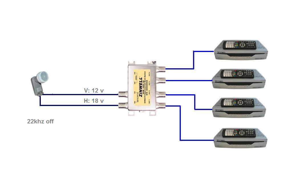

Do you have a multiswitch involved? You should with that setup
Here is what I mean (yes I know it shows FTA receivers but they work the same for Directv)

the setup that iceberg showed is the one that i have now that isnt working. Do i need a boost or something?
I think i do it's the same switch setup that he had shown there.

It depends on what you decide to do, If you do the SWM , it requires a Power inserter and a special SWM splitter as well.
If you go with the newer dish (Slimline), if you go over 4 tuners you'll want a WB68 Multi switch, that style is the only one that will work correctly for that set up.
A4x4 splitter will not work with the SWM set up, you'll need the SWM splitter.
