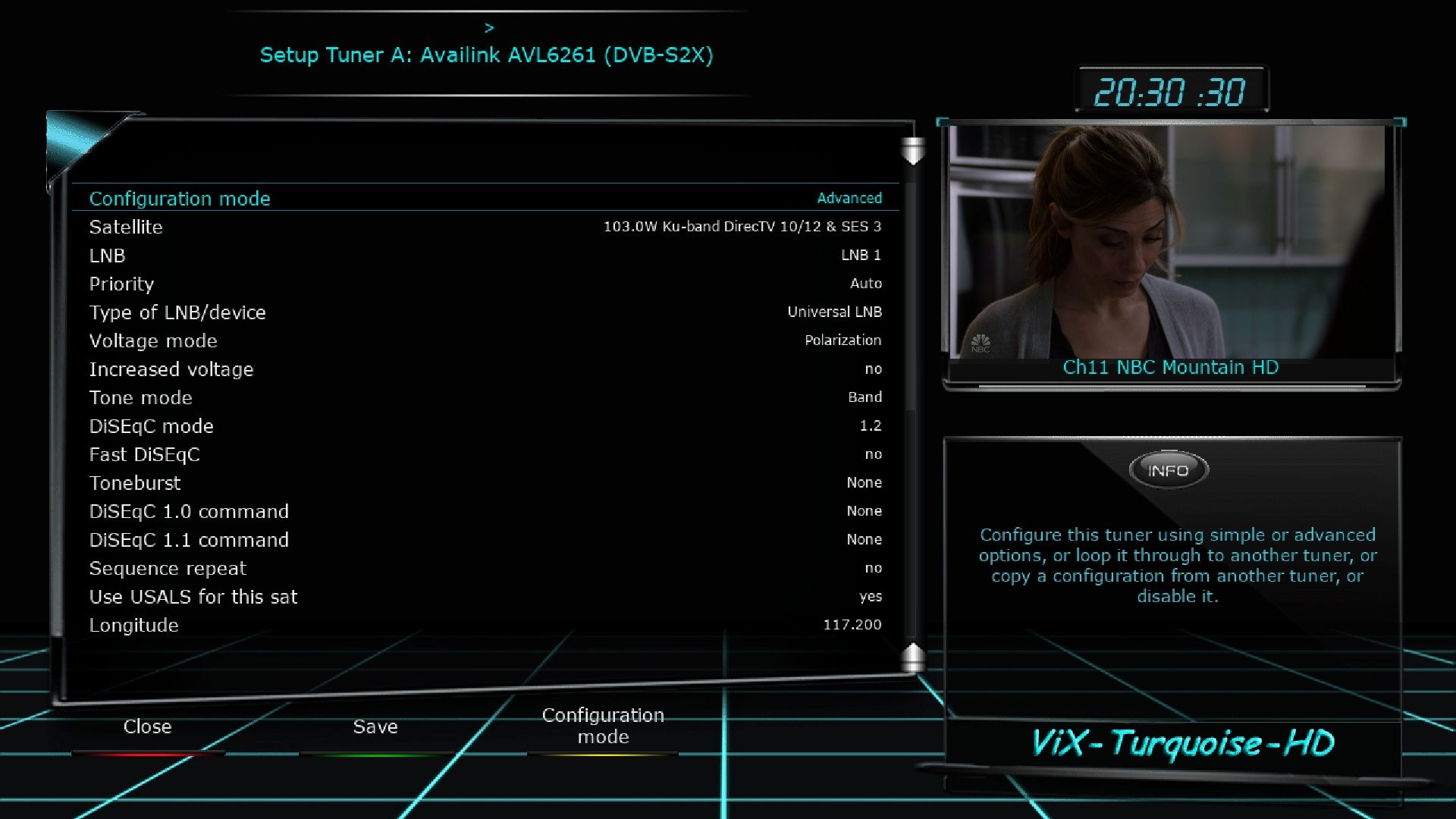

Thanks Brct203, I kept playing with it and got it going, the problem was the settings under the Tuner setup, here is a picture the way is setup now and working.
I haven't try to move the dish to a different satellite yet, I hope it works, find out tomorrow.

if you're using diseqc 1.0 switch (typical 4 port switch), you'll need to enter that port in that setting screen (it will be saved as a setting for that LNB entry, so that any other satellite that uses that same LNB will automatically get that setting)
