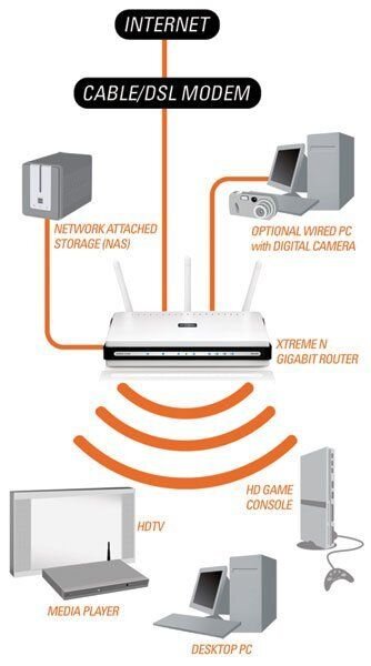

You need a router. Simple image of a router setup. You can hardwire more than the image shows; its just a simple example.

OK this is what I have, the Westell 2200 is a modem/router. The how to's and why's I haven't figured out yet.

Why is there 2 ethernet connections on the HR20-100 but we're always told touse the top one? I waswondering why I couldn't just connect the modem to the HR20 and then use the bottom ethernet to connect my HTPC. I'm willing to bet it won't be as simple as that, hea? :)

If your modem/router has ports on the back, just hook the HR20 to the router. If not, get a SWITCH, they're around $20-30. Plug that in to the router, then plug the computer, HR20, etc into the switch.

The Westell 2200 is a dsl modem + router without a built-in Ethernet switch. The piece of the puzzle that you are missing is the switch. Run down to the computer retailer of your choice and pick one up (they run about $25 to $50 depending on the number of ports and 100Mbps vs. 1000Mbps). Plug the output of the Westell into one of the ports on the switch. Plug the Ethernet port on your HTPC into one of the ports on the switch. Plug the top Ethernet port into one of the ports on the switch. Done.
