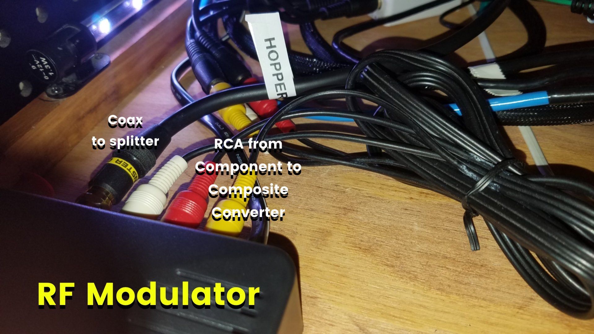

I have my Hopper 3 connected to the living room TV via a HDMI cable. And the Hopper is also connected to a component to composite converter (purchased from Amazon), then to a RF Modulator (purchased from Amazon, eBay, Walmart, etc.) and it feeds the coax that mirrors the Hopper to seven TVs in my house with an HD picture. This setup works great, thanks to JSheridan.

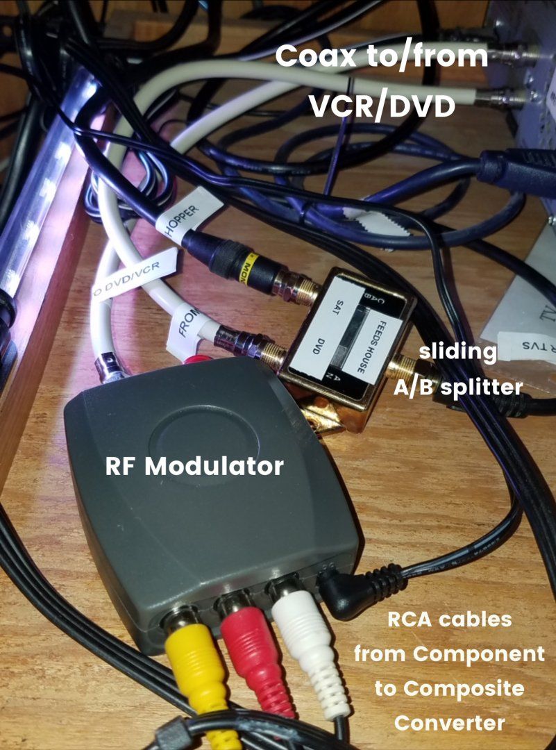

I wanted to add my VCR/DVD player/recorder combo to this setup so what is playing on the VCR/DVD will be seen on these seven TVs (it is already connected to the living room TV via a HDMI cable). I had this done previously with my ViP722K where the coax came out the coax output to a sliding A/B splitter. The A input was directly from the ViP722K and the B was from the VCR/DVD player/recorder combo. The output on this splitter fed these seven TVs.
To make my current Hopper 3 system work this way, this is how I was able to do it:

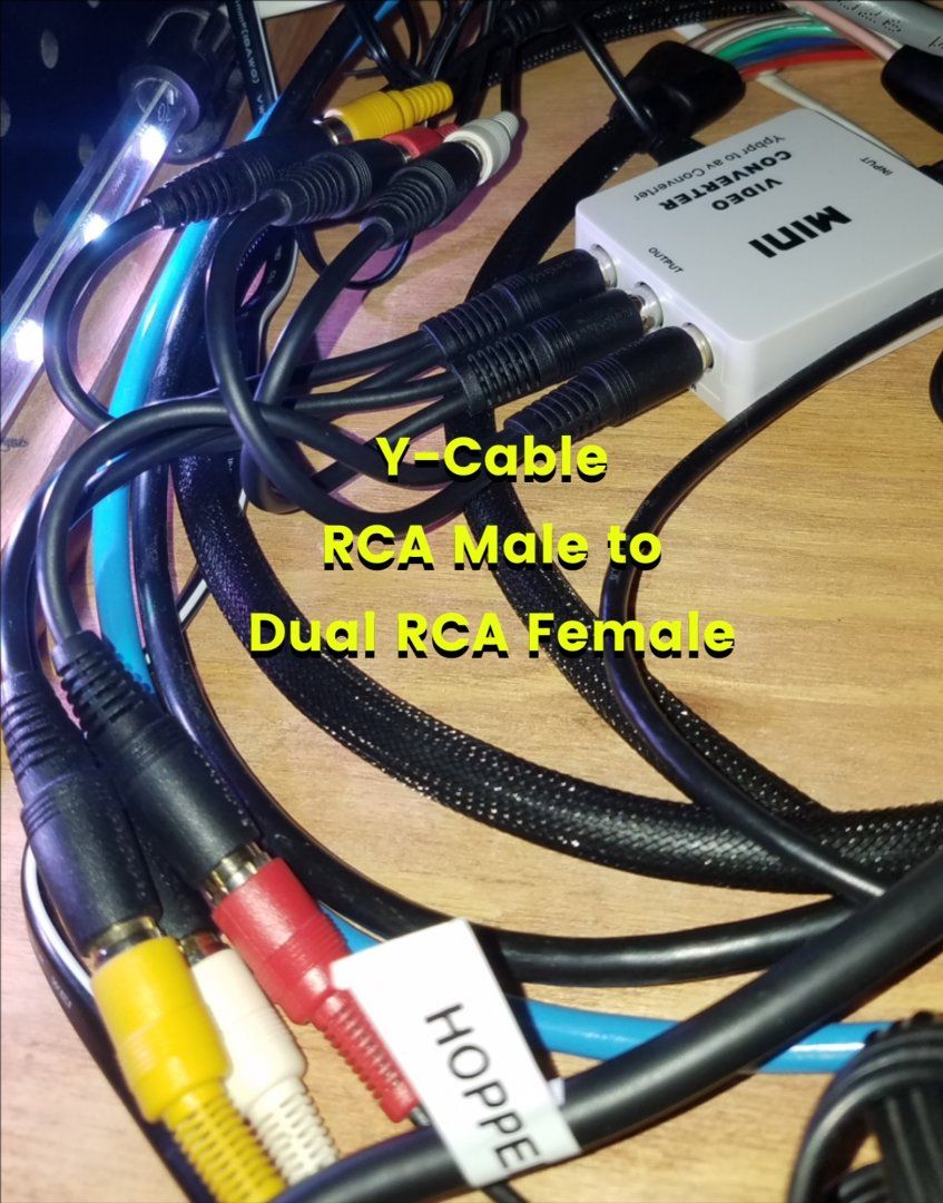

Before I connected the RCA cables to the component to composite converter, I installed three RCA Male to dual RCA female Y cables. I plugged in to one of each Y cable a RCA cable that was connected to the RF Modulator that feeds/mirrors the house with the HD picture from the Hopper 3 but instead of attaching the coax that feeds/mirrors the rest of the house, I attached it to the A side of the INs on the sliding A/B splitter. Then the OUT on that A/B splitter is where the coax is attached that feeds/mirrors the house.
Now I attached another RCA cable to the other half of the three Y cables and attached them to another RF Modulator that has been connected to the IN port on the VCR/DVD player/recorder combo with coax. Then from the OUT port of the VCR/DVD player/recorder combo a coax cable is run to the B side of the INs on the sliding A/B splitter.
With all the various coax, RCA cables and splitters, the picture that is mirrored throughout the house is a tinge less than what it was before but anytime I want to play a DVD in the living room, I can also view it on any of the other TVs in the house.
