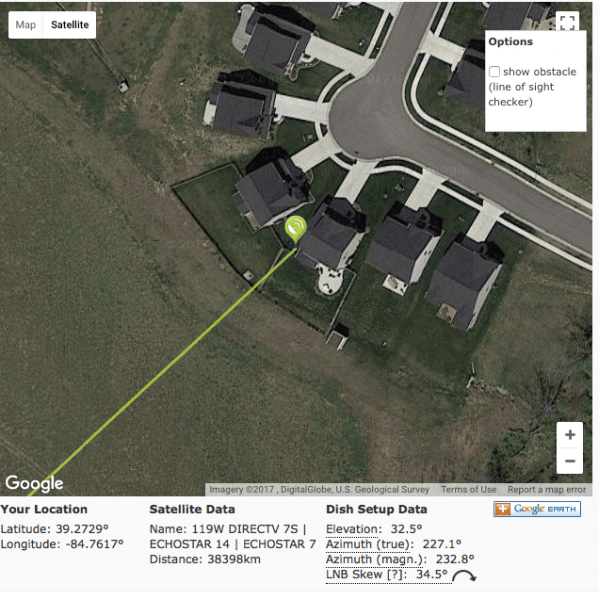

You need to get all three satellites on the Eastern Arc, 77, 72.7, 61.5
Unless you are buying your own equipment DISH will likely insist on installing it.

Thanks, I guess that would be slightly in the other direction of where Directv was then.

would this be correct for the eastern 77 , 72.7 and 61.5 then Echostar 14 and 7 ? see attached.
