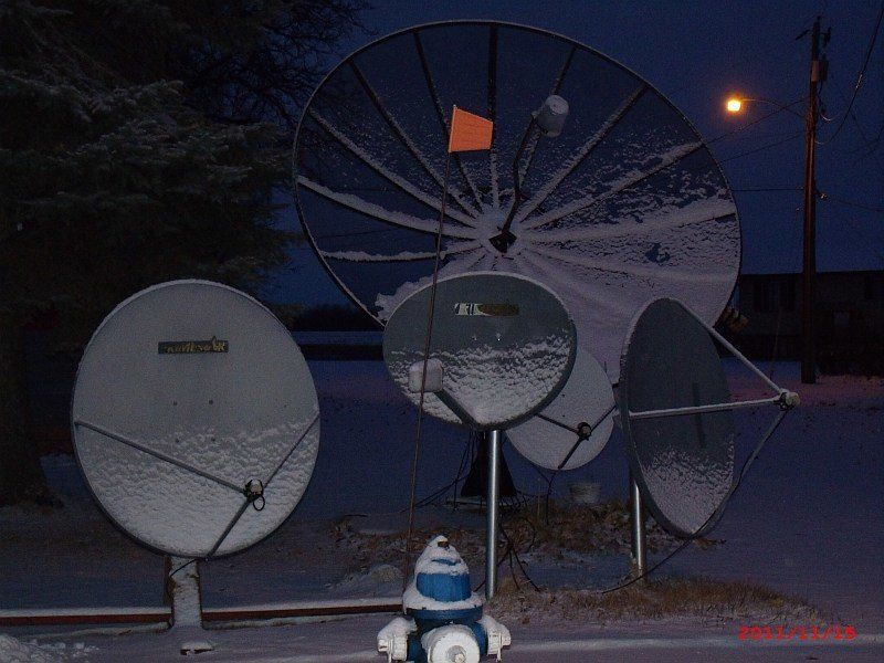

Mines in the front yard, 20+ years. Right on the corner. With 4 Ku dishes in front of it. Neighbors are amazed when I answer their "how many channels" questions.

That's pretty cool actually. Almost barely notice that huge mesh dish behind those KU dishes. But of course it looks like you took those shots in the dark. In those 20+ years they've been there, has the fire department ever had to use that fire hydrant for anything?
They just flushed it out a few weeks ago. Never has been used for its emergency purpose. It's kinda deceptive, it's actually 8-10 feet away from the dishes. And there is no hose coupling on the side toward the dishes.

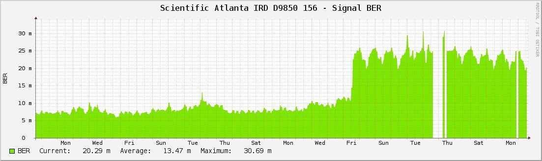

I've had issues since Friday night (11/2/12). Here is a graph of BER.
As you can see it was Friday night that the signal went to crap. It has stayed at that BER since Friday night two weeks ago. My IRD locks, reads the NIT, but there are too many errors in the audio and video. I have been using a Fortec 6 footer for the past three years or so.
