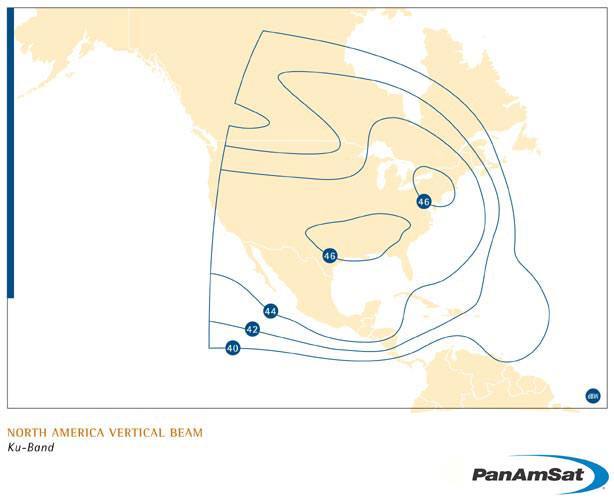

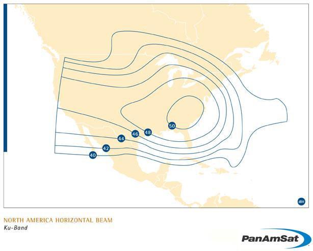

central Texas
FTA use going on 10 years; 70 cm Ku / 8' Unimesh C / 10' Winegard C.

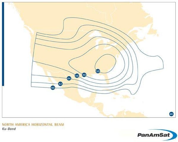

Make sure your LNBF SKEW is correct. Also, check the dish alignment. Signal should be strong in TX.
