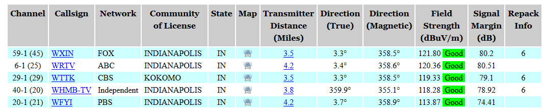

CBS 29-1 Kokomo, IN I am 3.5 miles from the tower and get weak signal from antenna.
I'm betting you're actually getting a signal that is too strong rather than weak. The predicted difference in signal between WXIN and WTTK is 2-1/2 units. I suspect that the tuner is reporting the signal quality rather than the signal strength. A signal that is distorted due to being over-driven will have a low signal quality.
Being that close to the towers can be a problem -- especially if you also want distant stations.
