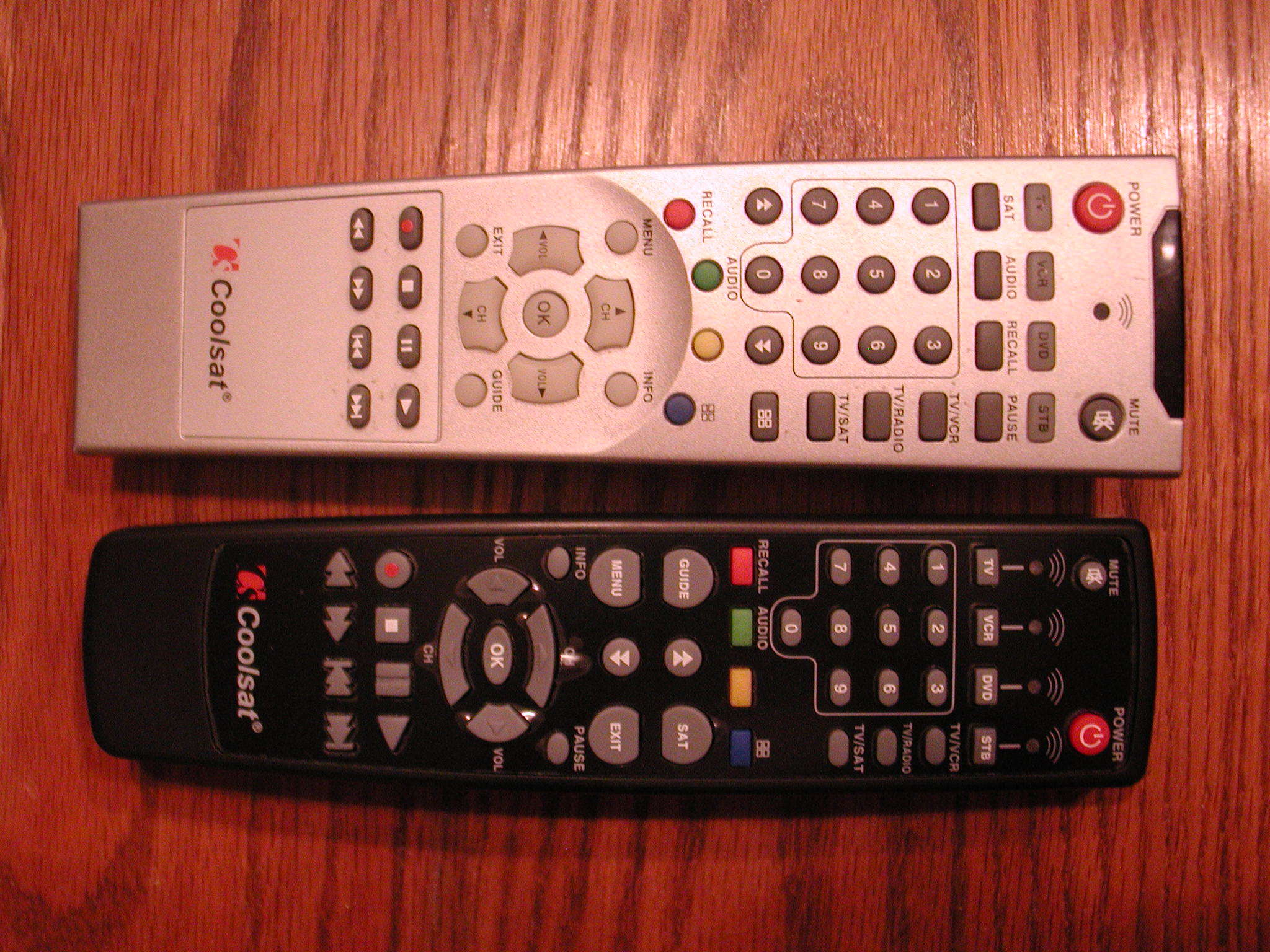

Ok, I finally had time to look at these. I first downloaded the channel list from my current one and uploaded it to the new one.
No problems there. The loader reports Version 1.00 found on both receivers.
Everything works. Channels come in great. Blindscan works fine. It ALL JUST WORKS.
Next, I like the remote on the new one a lot better. It's laid out a bit more intuitively.
I see absolutely no difference exterior wise or menu wise between the two.
Well... I say that...
I was planning to open the cases up and compare the internals, BUT... my old receiver has no seals on the case (warranty seals, that is) while the new one has two holographic CoolSat seals on the front and back. I decided against breaking them since this is a gift for my dad (our family get-together in on the 1st, so he hasn't gotten it yet.)
SOooo.... If I was going to guess one of these being a clone, I might point at my old one since it has no seals on the case... but, maybe they didn't put any on the older models...
Any thoughts on that?
One pic coming up...
Sure thing -
The black one is the new one.

well the one thats black is like my coolsat 5000 & 6000 remote

Regarding the remote, mine is just like the black one in the previously posted picture, but mine is silver, not black.
