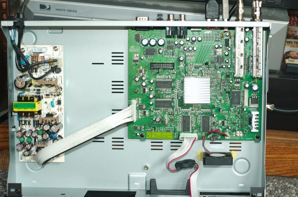

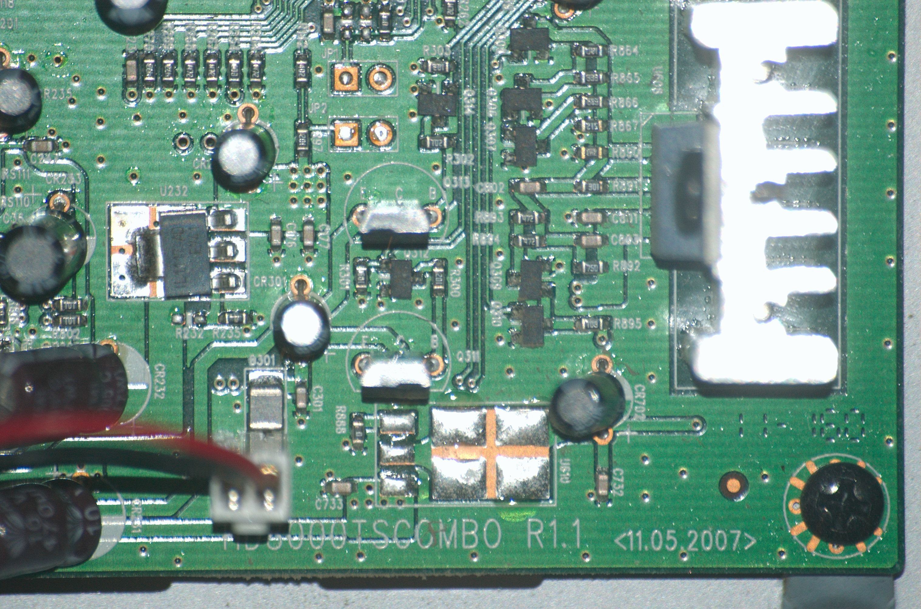

However, I'm curious, relative to the fan not shutting off when the receiver's switched off. It might be that if the fan was installed by the previous user, that he didn't connect it to the power point on the motherboard which is switched. Ie where is the fan plugged in? The motherboard on my 8100 is actually an 8000 motherboard, and the fan plugs into a little plug at the front right (when facing from front). See pictures attached below.
I seem to remember someone posting a picture of an 8000 motherboard which was different, and even if it was the same motherboard, the plug might not be installed, however you might get lucky and have this motherboard, and be able to tap off the same location on the motherboard. Of course the 8000 firmware might be different too, and not switch that location, or there might be components missing that get power to that spot, but it's worth a try.
With the 8100, the fan is pretty important, because the thing will get very hot without it, and usually the receivers will reboot or freeze up. Other people have posted about mounting a regular big computer fan on top. When the fan on one of my 8100s burned out, I put one right on top of the case, so it was drawing air through the holes on top, and that kept it pretty cool, but the way others have described doing it would be better. The little postage stamp sized fans make more noise than a computer fan, and draw less air.

Makes perfect sense that Coolsat would use the same motherboard in 8000's and 8100's.
Sounds like they ditched the 8000 board as the 8100 became available.
That little fan BJ shows ahead of the motherboard (thanks for the pix! :up ) will barely make a draft.
