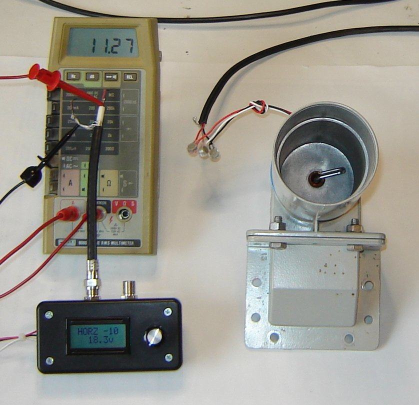

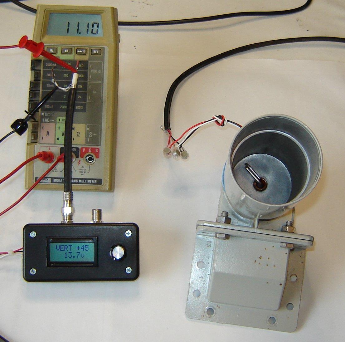

Here's a couple of photos of the servo controller connected to a C band feed horn and a current meter in line.
Looking down the throat of the feed horn shows the angle of the probe antenna.
This photo shows the skew adjusted 35 degrees from default of -45.
Turning the knob gives up to 90 degrees of skew if needed.
