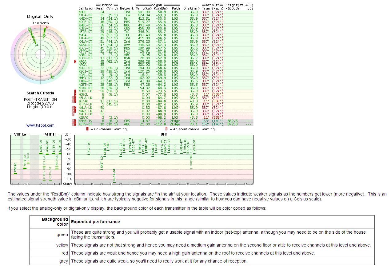

My zip is 92780, its about 38 miles away from LA station. What about the CM4228 and XG91, heard their one of the bests. I do have hard times trying to get CBS and NBC.
Also, all the station are pointing to 325 degrees so I'm guessing I need a very directional antenna.
Well, IMHO, based on what your area's digital landscape will look like post-transition; I would recommend a good VHF/UHF combo antenna that is mounted at or above the roof line. You could try the CM4228 (that is what I use now) and if you are not happy with it's results receiving the VHF Hi channels then look at the combo models. I would hate for a user to buy two items; ultimately spending more money than needed.

VistaXP,
You don't need such a large antenna.(CM 3679) You won't have anything under channel 7; so I would suggest one of the much smaller channel 7-52 antennas from Channel Master, or Winegard.(I prefer Winegard because of it's waterproof balun and much better durability).
The 4228 would be a good choice if you didn't have that channel 7. It's probably a bit too weak.
