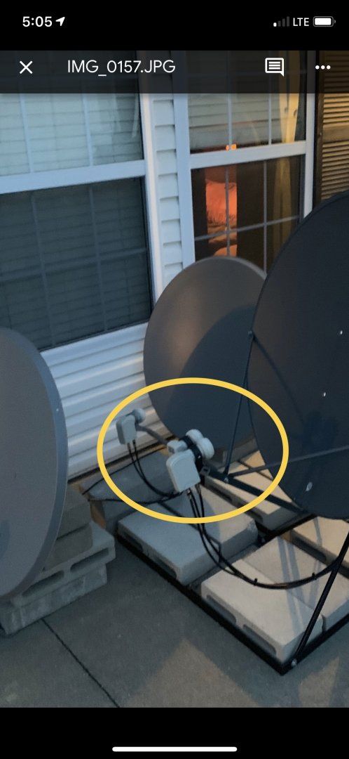

I have a dedicated 90cm dish parked on 103 and it seems the LNB has to be skewed pretty far to the right for me to get everything on that sat. Not sure where you're located, but maybe try skewing the LNB a bit.

Just looking at COZI now. ON the Openbox S9, the Q is 75 and solid on a 33 inch dish. I did have to tweak the dish due to very high winds this past winter. All the other TPs are very good as well.
