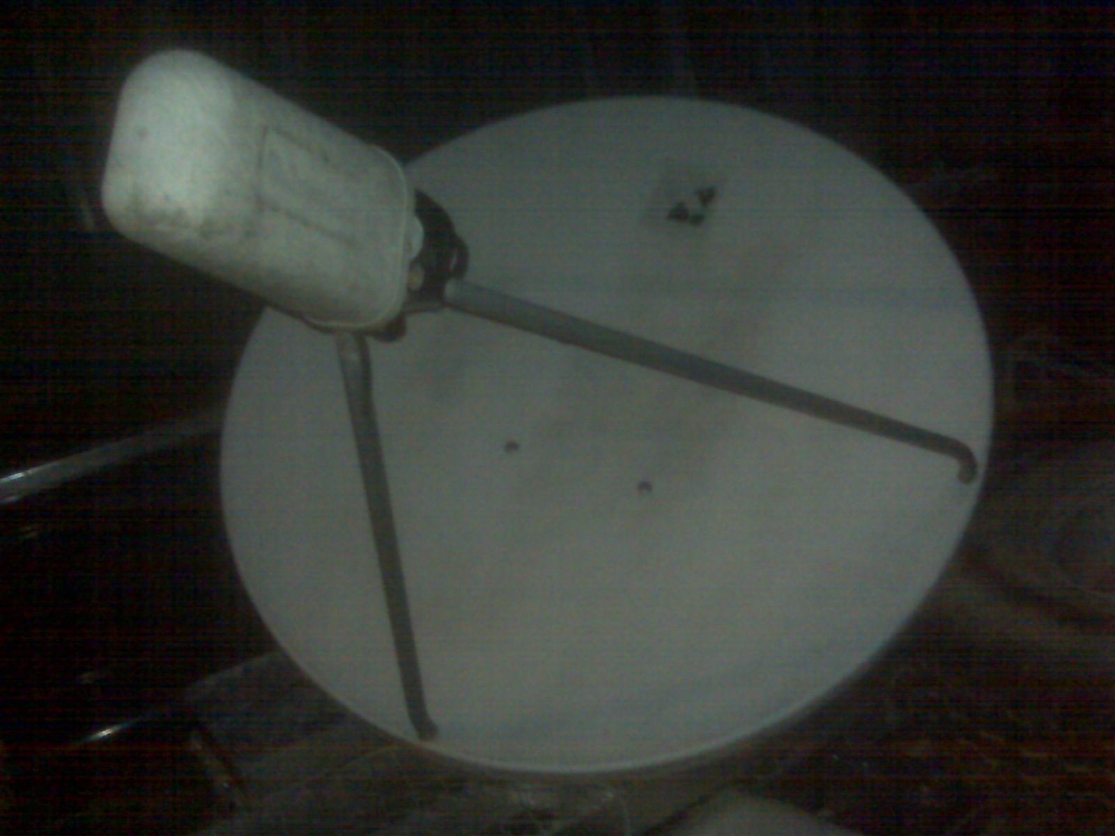

I found this on dish on craigs list today. Seems to be in great shape and all there. Will this work out ok for 101 or 125 sats? I did not think it was too bad of a buy for 15 dollars since it was on the way home anyway :)
That's a keeper! Looks like either a 1 meter or 90cm ChannelMaster/Primestar dish. The LNB may be only single polarity, but there are models available - it's a c120 flange - which will bolt right up to the feedhorn. I have a 90cm and get everything from 72 to 125 on it. Keep us informed on how it works out for you.
I have not had time to look at it too close. Tomorrow will be more telling as I will get a better look. I just made sure the el/az adjustment head was there and that the dish looked good and not torn up. Looks pretty nice for the price. I will let you know more as I get to look at it and test it out.

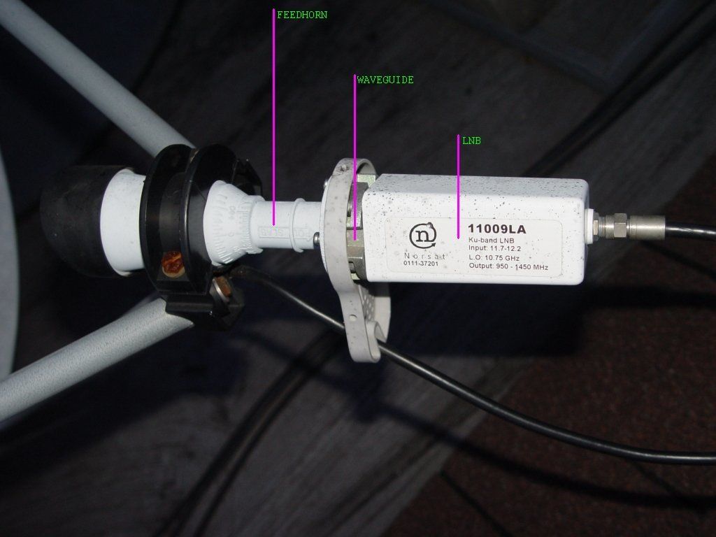

A C-120 flange is a common standard mounting interface between the feedhorn and LNB when they are both separate parts, as they are on commercial dishes such as that one.
There are basically four screws holding the LNB to the feedhorn. Once you take those screws out, the feedhorn and LNB (or waveguide/LNB assembly) will separate. You can then install a new LNB with a C-120 flange, such as the FSS LNB from a Dish Network Superdish or a Hughes LNB, to the feedhorn and get both polarities.

I did a quick look at it this morning. it is CM 90M-1 so that is the 90 CM model I am guessing. Measures 40 in hieght and 36 in width.
I does appear to have a sigle polarity LNB on it. So guess I will have to figure out the method of swapping the LNB. I am assuming that I can keep the feed horn and just install a new LNB body? Is that what is meant by saying it is a 120 flange?

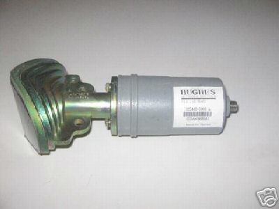

Three choices come to mind, if you want to stay with the existing feedhorn.
- expensive Invacom QPF-031 (not to be confused with the QPH-031 which has a round feedhorn built in)
- Hughs LNB as shown in picture below (credit to Tron, I think)

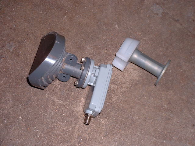

- DishNetwork bandstacked LNB from SuperDish (credit for pix to Tron again)

Looks like the Huges lnb is the same as the Eagle Aspen 270. Will it mount up to the LNB holder if I take off the clamp from the top of the holder?

Both the Eagle Aspen P270(dual conn.) & the Hughes(single conn.) will work with the C120 feedhorns. Both are dual polarity. Either one is a lot less expensive than the Invacom.
Hughes DirecPC lnb ebay item #190277299643
Yes, the feedhorn is separate from the LNB, and has the C-120 flanged interface to mount to any compatible LNB. I have attached a picture of a single polarity LNB mounted to a waveguide, which is mounted to the feedhorn of a Channel Master dish (same as your dish).
If you take off the single polarity LNB and waveguide, the Hughes will bolt right onto the feedhorn where the old assembly was attached. Remember to keep and reinstall the O-ring that should be sandwiched in between the feedhorn and LNB for weatherproofing.
Here is the link with pictures of the Hughes on eBay - Hughes DirecWay: DirecPC LNB FSS SAT2 1025448-0008A KU - eBay (item 190277299643 end time Oct-22-10 10:43:23 PDT)
As Tron said, it will bolt right up to the feedhorn. Do take out the waveguide though. When I first changed out mine from the single polarity lnb to the Hughes I left it in and something just wasn't right. After looking things over and making some measurements I decided to take the waveguide out and Bingo! Made a world of difference.
