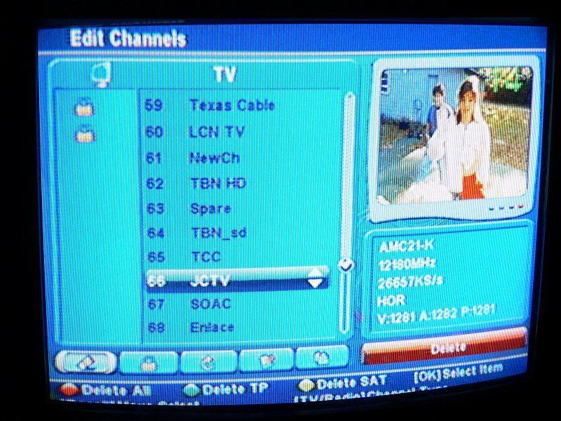

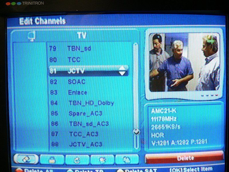

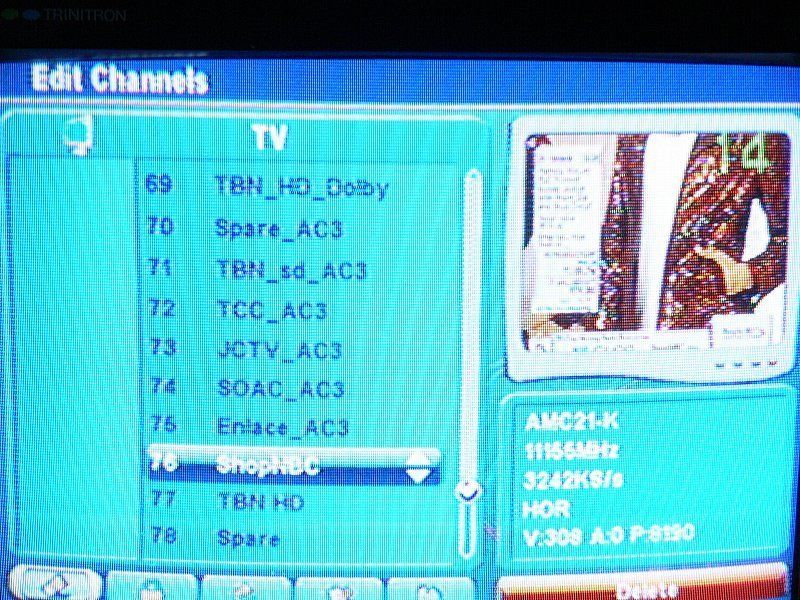

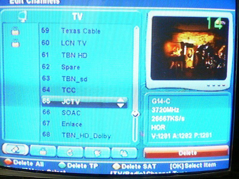

In my satellite listing I have both G14-C and AMC 21-K, So I also get them in C when I scan that satellite at the correct Freq. But also in KU and as my pictures show they are also scanned in as KU when I scan AMC21-K , but I don't see a listing for these in any listing so far. Something is wrong and just not sure what and I've not had any other issues when I scan other satellites. Just this one.

Your tracking is apparently good enough for you to see G14, but that doesn't mean that it's good enough to see AMC21, because you need more accuracy to tune Ku.
The channels that you think you're seeing on AMC21 are not on AMC21, they are on G14. Ie you're seeing the same C-band channels when you tune to AMC21.
For example , 5150-3720= 1430=12180-10750 . Ie you receiver is not seeing Ku band at all, it's only seeing C band.
You say that you're using an LNBF, rather than the co-rotor. So the question is, how are you telling the LNBF to switch between C and Ku? With some, you have to use an external switch, either diseqC or 22KHz. Other C/Ku LNBFs have an internal switch, which might be a diseqC or 22KHz. If it is indeed the 9750/10750 universal that you mentioned before, the universal Ku will need to use 22KHz for switching bands, so the odds are that your LNBF needs you to specify C vs Ku via ports 1 or 2 on an internal diseqC switch, OR you need to use your own external diseqC switch. So somewhere in the AMC21 satellite setup in your receiver, you need to specify either diseqC port 1 or 2, depending upon which one gives you Ku band.
Doing that should get you to Ku, but you'll still probably need to fine tune your aim to maximize the Ku signal.
