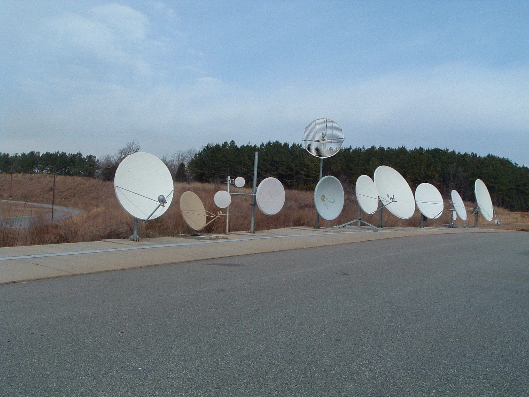

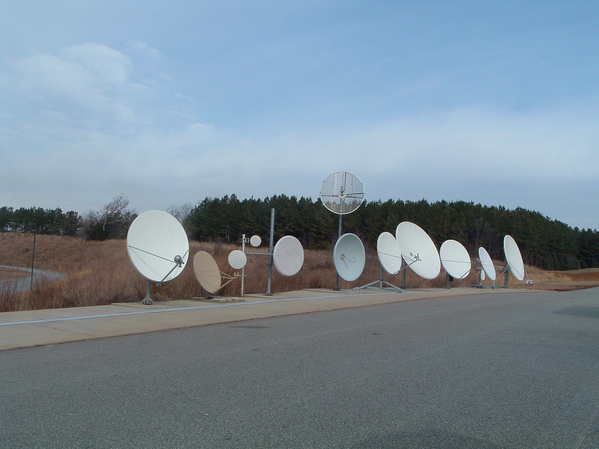

I did pick up my 1.2 Prodelin dish from General Dynamics SATCOM Technologies warehouse in Newton, NC. Here are a couple of pictures of their products that were in the back of the warehouse. I purchased the 1130 RO/dish, check out the spec's.
http://www.gdsatcom.com/Antennas/Data_Sheets/76-1-12ro.pdf
